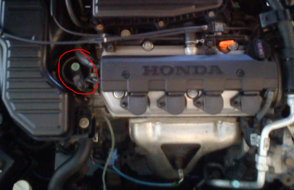

My 2002 EX had EGR, not all of them got it but some did. If yours has the think circled in red below then it has it.

Your engine should have an EGR mounted near valve cover passenger side. Here's a couple reads about intermittent misfires: http://www.autotap.com/techlibrary/analyzing_ignition_misfires.asp

New plugs looked fine. It looks like my car does indeed have an EGR as well.
