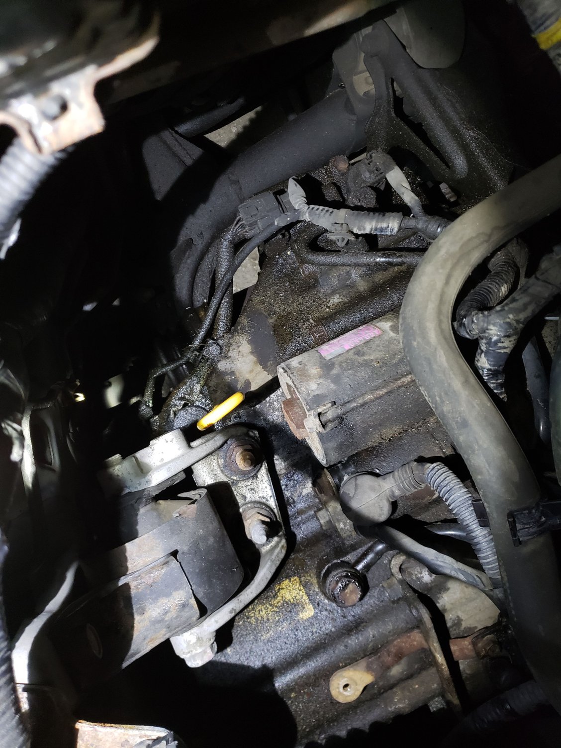

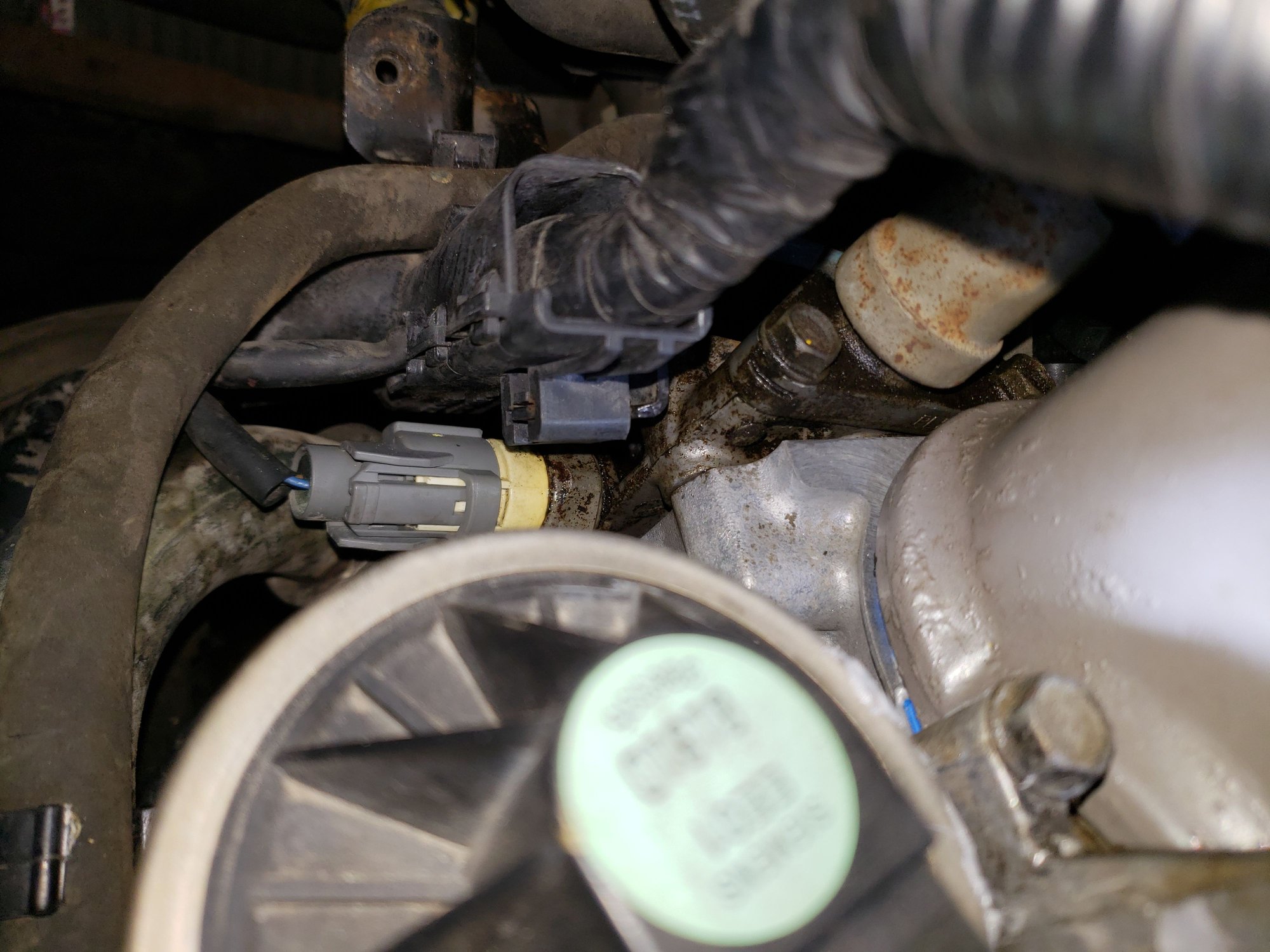

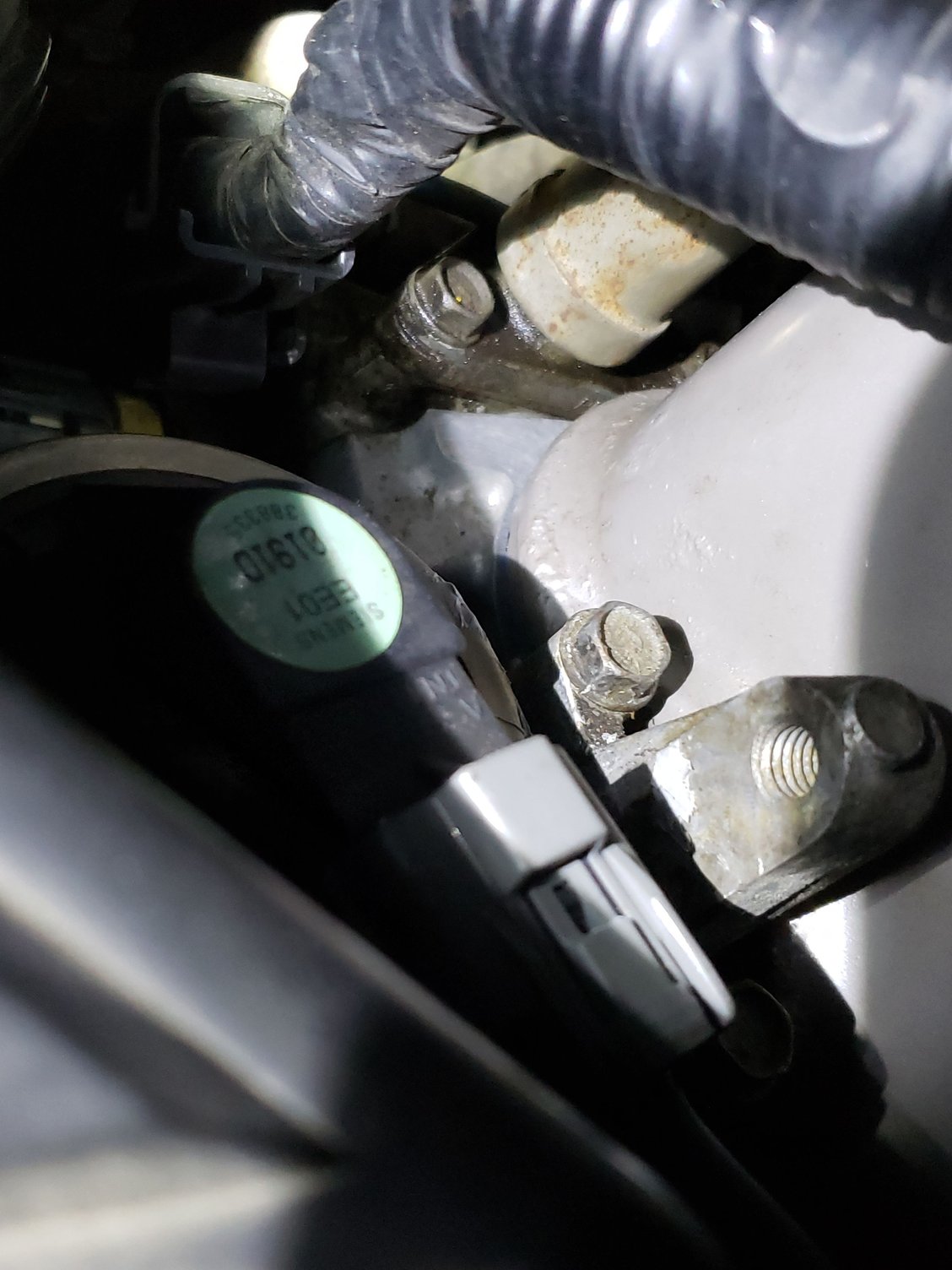

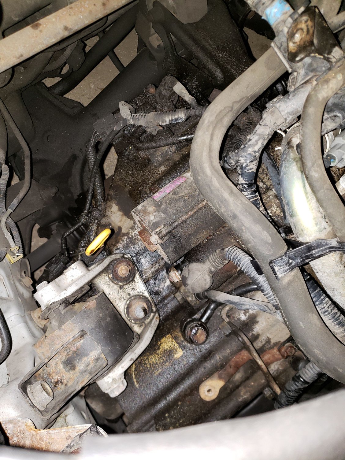

Hey hope I'm in the right section, I have a oil leak and cant find out where it is coming from?
My Honda Civic has burnt oil all over and leaking oil too.
Do any of you guys have an idea or suggestions where the oil is coming from?
100% VTEC solenoid is leaking has bubbles.
Can that oil leak reach and produce that much of an oil leak?
Sorry if pictures are dark

VTEC solenoid is a common place they can make a mess. So is the cam seal plug (side of head where the cam is at).

Cam seal plug has no leak recently replaced any other suggestions?

That transmission mount seems blown, it comes preloaded with hydraulic fluid that might have spewed out.
Hows your automatic transmission fluid level doing?
While that may seem like a huge leak, just a few ounces of oil will have a similar result.

Transmission fluid not low looks good.

so you know the vtec solenoid is leaking, replace the gaskets, clean up the engine bay real good and see if there are any other leaks

Okay I'll try that also, could it be the oil pan or rear crankshaft main seal?

The oil shown in your pics are not from the oil pan or rear main seal..as oil would not leak up, only down.

not in those pictures
Originally Posted by HR Puffinblunts
oil does not leak up, only down.

Buddy told me according to pictures could be because air will force oil back and forth is this true?

Not in this case. It's oil leaking down. In the case of a torn CV boot grease can jizz all over the place but that's due to the rotation of the axle.

Okay I ordered VTEC solenoid gasket going to replace hopefully fixed cant think of anything else could be causing it

there's 2 gaskets, did you get both of them?

Yes I did

Yes worked for me not leaking anymore
