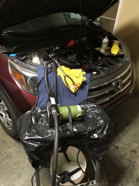

http://honda.oemdtc.com/264/low-heat...014-honda-cr-v
Harbor freight pump and 2 fittings from Home Depot . mix twice the amount by getting large bottle of CLR and 2 gallons of water. Pump will get hot because it is a transfer pump. I didn't drain system, car only has 60K. clamp off heater hoses to engine. You need the hose pliers to keep from damaging the heater hoses when removing from the firewall. Run for 2 hrs normal flow 1 hour reverse (twice the 1.5 hrs on the service bulletin for CRV's) flush with serveral clean buckets of water. Thanks to member EZONE . j.d.
Originally Posted by j83460
Harbor freight pump (I bungee strapped it to cheap folding work table in case it vibrated) and 2 fittings from Home Depot . mix twice the amount by getting large bottle of CLR and 2 gallons of water. Pump will get hot because it is a transfer pump. I didn't drain system, car only has 60K. clamp off heater hoses to engine(those clamp pliers are larger than required). You need the hose pliers to keep from damaging the heater hoses when removing from the firewall. Run for 2 hrs normal flow 1 hour reverse (twice the 1.5 hrs on the service bulletin for CRV's) flush with serveral clean buckets of water. Thanks to member EZONE . j.d.
here are the fittings (teflon tape if desired when screwing into pump) , buy some decent 5/8 radiator hose (remember shorter hose can go from pump suction side into bucket, longer section from outlet of heater core down to bucket, and medium length from pump outlet into heater core), 4 basic hose clamps. look up the service bulletin from honda on CRV's. they show a filter screen on the pump outlet. I didn't need that. there were no particles in the bottom of the bucket.
