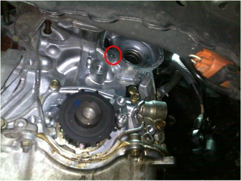

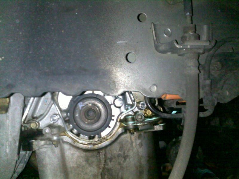

Well, it looks like the engine will come down about an inch before the A/C pulley hits the subframe. I measured and need the engine 3-4" lower to get access to the bolt.
Here's a picture of the snapped bolt (circled in red) and another picture of the crank pulley so you can get an idea about how far down I need this sucker.
Any ideas? Will the engine lower these 3-4" without removing anything other than what's required to remove the subframe? If so, what's the best way to proceed from here?
Honestly, I've never tried so all I can do is guess.
Pull the AC compressor off of its mounts, see how far that lets the engine drop?
Short of actually pulling the subframe out to let the engine down further, I don't know what else you can do. Even then, I still don't know how far you can drop before you need to disconnect a bunch of other stuff.
Sorry, I'm not full of answers on this one.
Right angle drill? IDK if there is enough room for one of those either.
Hey, is the bolt broke off in aluminum....or steel?
I started thinking too much and now I can't remember what the front of the engine is made of. Brain fart!
Steel, right?

I think there's enough room for the right angle drill, but I don't think I can get a punch and hammer in there to start the hole

Removing the subframe sounds a little iffy for my capabilities. Ugh, might be time to call around and get some repair estimates
