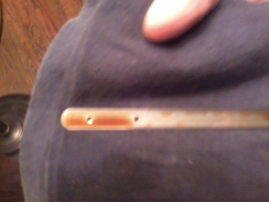

Naw. Solved that problem- had a half a case of no-name filters that I was finishing up. I'm using good filters now and it's fine. Had the valve cover off last week and no sludge in there. What I could see of the cylinders thru the plug holes looked fine. Also when I change the oil I usually let it drain for awhile, like 30 minutes or more. I hardly ever put the plug in or filter on when it's still dripping.
3.7Q w/filter is the capacity. I wouldn't think over-filling by 3/10Q would be that bad.
For the record, this is how it sits at 1000 miles after the last change:
And, no it's not losing any oil. It's in tip-top shape.

Re: 2005 EX SE Low Oil Level
oh okay looks good on the stick.
