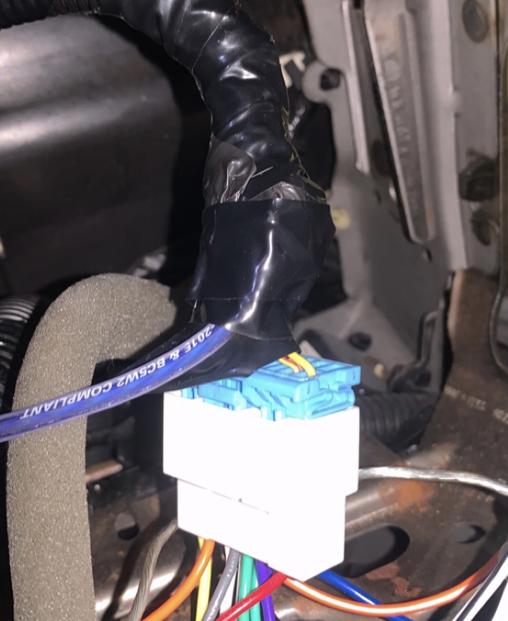

I have a 2005 Civic EX Coupe. My friend was attempting to help me with installing a kill switch to the aftermarket radio because I was (mostly) sure that it was draining my battery even while the car is off. But that's not the issue here. The issue is, while my friend was attempting to figure out the voltage coming through the factory harness (blue plug) he shorted out the ignition wire by shoving a stray wire into the factory connection (literally don't ask, I don't ****ing know why either). Right now it's only pushing 2V on both the factory plug side and the aftermarket harness side. The battery wire is pushing 12V on both the factory plug side, and the aftermarket harness side. And before you ask, yes, I had a solid ground. I used the metal from the blue clips on the ground wire of the aftermarket radio's harness. *All of the connections between wires are crimped with fast wiring blue clips (twist on's for speaker wire)*
Alright, so my current issue is obviously that the ignition wire for the factory harness is shorted and practically shot. I noticed that the factory harness connects to another harness behind the HVAC system and radio, but I have no idea if the shorted wire goes beyond that. None of the fuses that seemed relevant were shot; I even checked the ohms on them with my multimeter, and they all read at zero. I also don't know if there are any inline fuses anywhere that might be shot because of this.
Unfortunately, I still have more.
So, the previous owner installed an aftermarket alarm system that I've used for a majority of the life of the car. Only recently have I uninstalled it and programmed a factory FOB to it. But, because the aftermarket alarm was still wired into the car (I just unplugged the control box, basically) I re-routed the shorted ignition wire from the factory harness to the ignition wire on that aftermarket plug. I clipped out the excess wire from the factory harness so that I wouldn't have any disruption in ignition power between the aftermarket alarm harness and the factory harness (since the factory harness wire is shorted anyways). In doing so, the radio works BUT every time I turn the car off it factory resets.

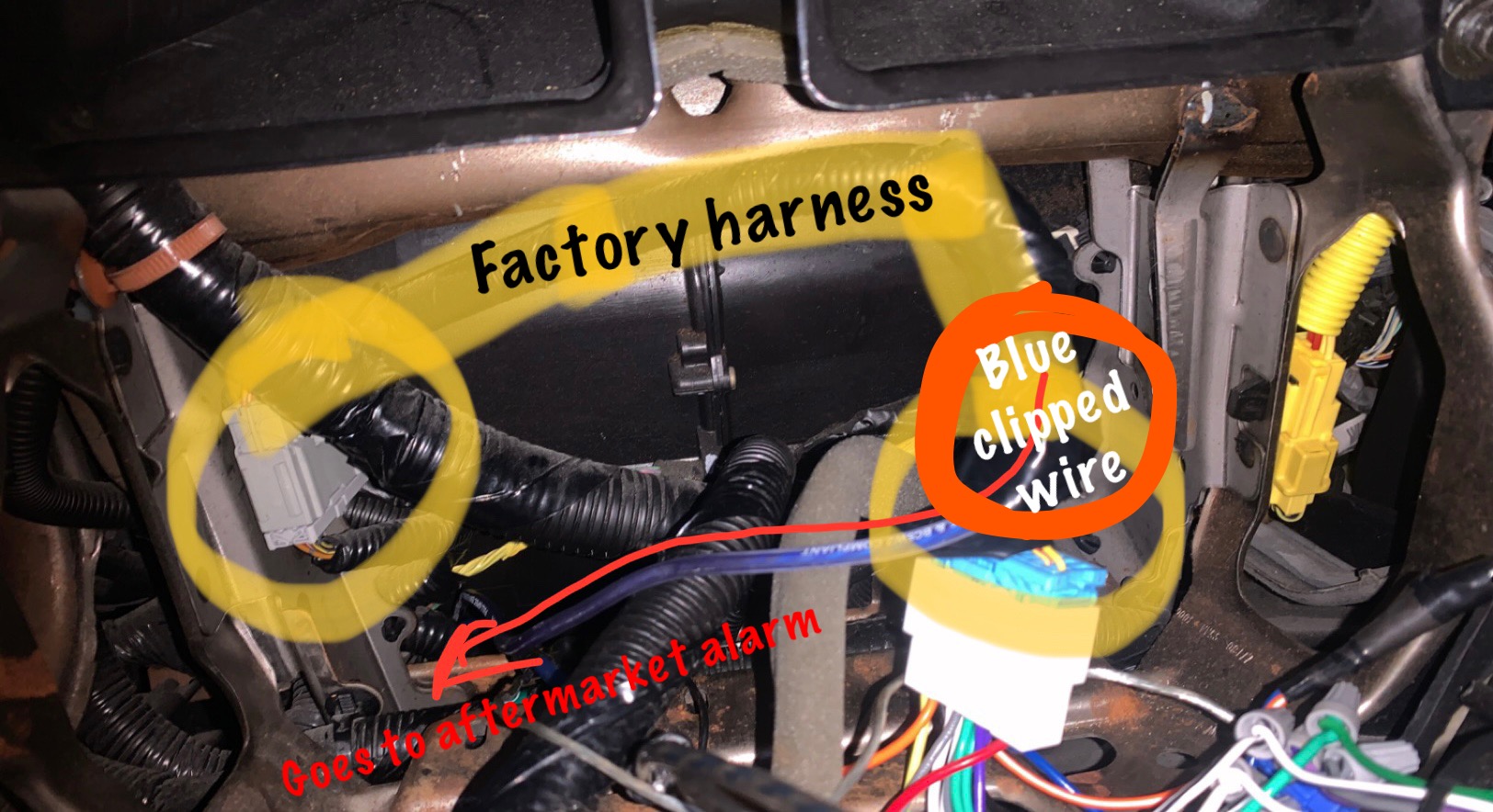

I know for sure the ignition wire is shorted and shot, but I don't know how far back it goes... what's the best way for me to get my radio working again AND keep everything else working as normal? Can I re-wire the shorted out ignition wire somewhere else? Can I just replace the whole harness that's between the blue plug and the gray one it plugs into (first photo, yellow circle on left)? Assuming they even make that anymore.
Thanks y'all.

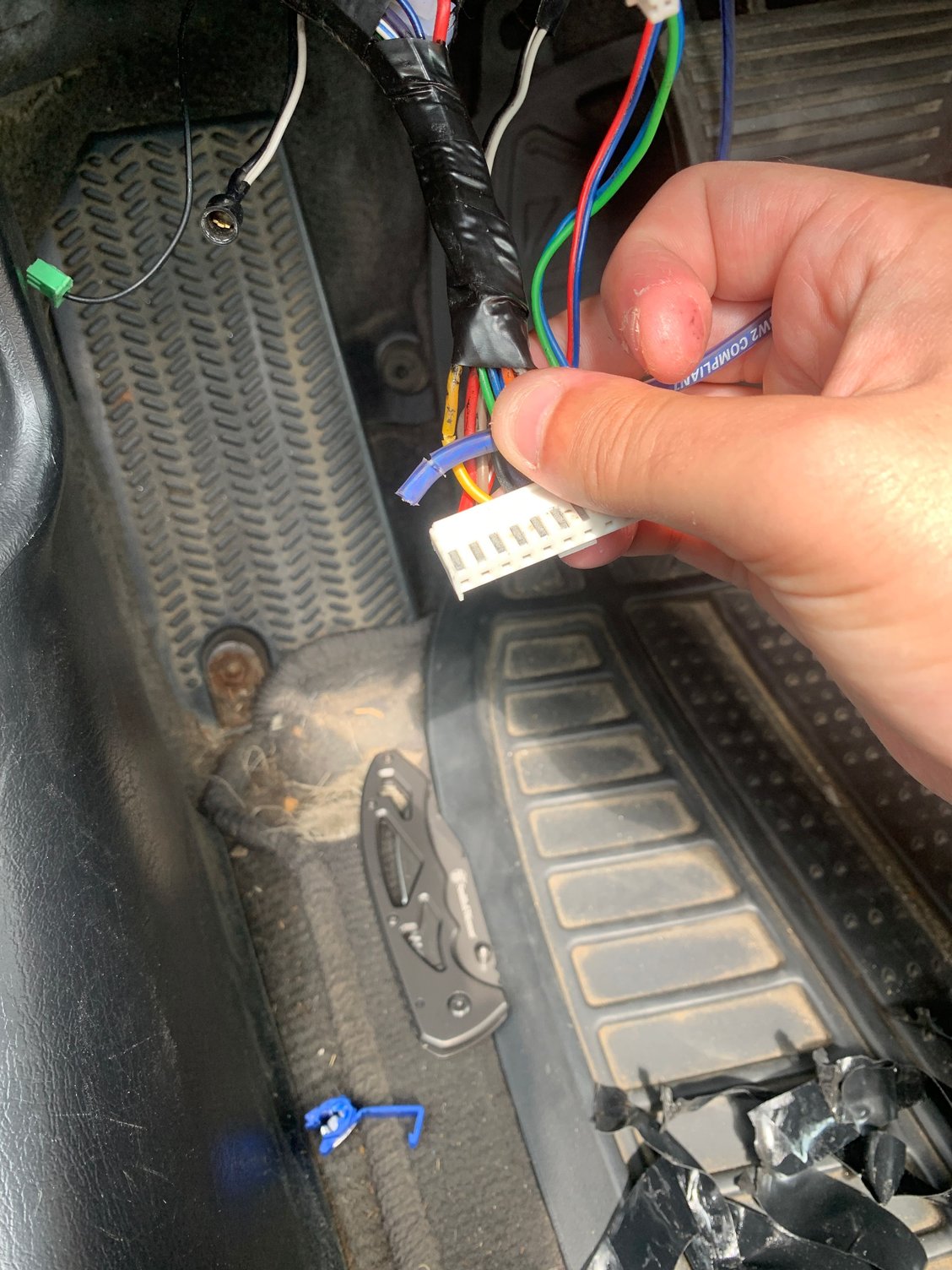

I've attached photos, labeled as best as I could. I also included a PDF of the instruction manual for the aftermarket alarm. Unfortunately I had already closed everything up because I thought the issue was solved, it wasn't until I went out to get food that I realized everything else that had stopped working.. that's why everything is covered in electrical tape and the photos are so dark. Sorry ahead of time for my awful labeled photos. I tried to explain it all well, but I'm sure some of it is confusing.

I have checked all of the fuses in both boxes (under the hood and under the steering column), and found a blown 10A fuse that the manual labeled as "back up". Thank god it was a fuse and nothing major beyond that. Replacing that fuse has fixes issues 1 through 5. However, obviously the radio still doesn't turn on because I've disconnected the newly routed ignition wire. But for whatever reason, rewiring it to the aftermarket alarm's ignition wire causes the radio to factory reset every time I turn the car on.
So here's my new question: Where can I rewire the factory ignition wire to that won't cause it to factory reset each time the car is turned off? Is there a wire on the aftermarket alarm's harness that would work better? This has been a roller coaster for me for the last 36 hours, believe me.
Thanks guys.
**FINAL UPDATE**
Once I replaced that fuse it all worked as normal. That wire that was previously reading 2V is now reading 12V. I used that blue wire and an additional blue clip to connect the wire I had cut out of the back of the factory harness. All hunky dory now.

Just removed crimp from extension blue wire and yellow ignition wire from aftermarket alarm. The wires are still disconnected until I find another solution, but I at least know this one works (just not the best).

You need to fix all hacked wiring, remove the alarm, and wire the stereo properly (no twist connections).
That short shouldn't be too hard to find once you get into things
