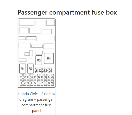

My hazard lights flash properly on the left; but on the right the headlight, taillight, and arrow on the instrument cluster are all not flashing. The turn signals work.

Check the hazard relay in the Under-Dash Fuse/Relay Box. It is the big square one marked R4.

Thanks @NDNV for looking up the diagram. I replaced the relay, but still have the same problem. :/
