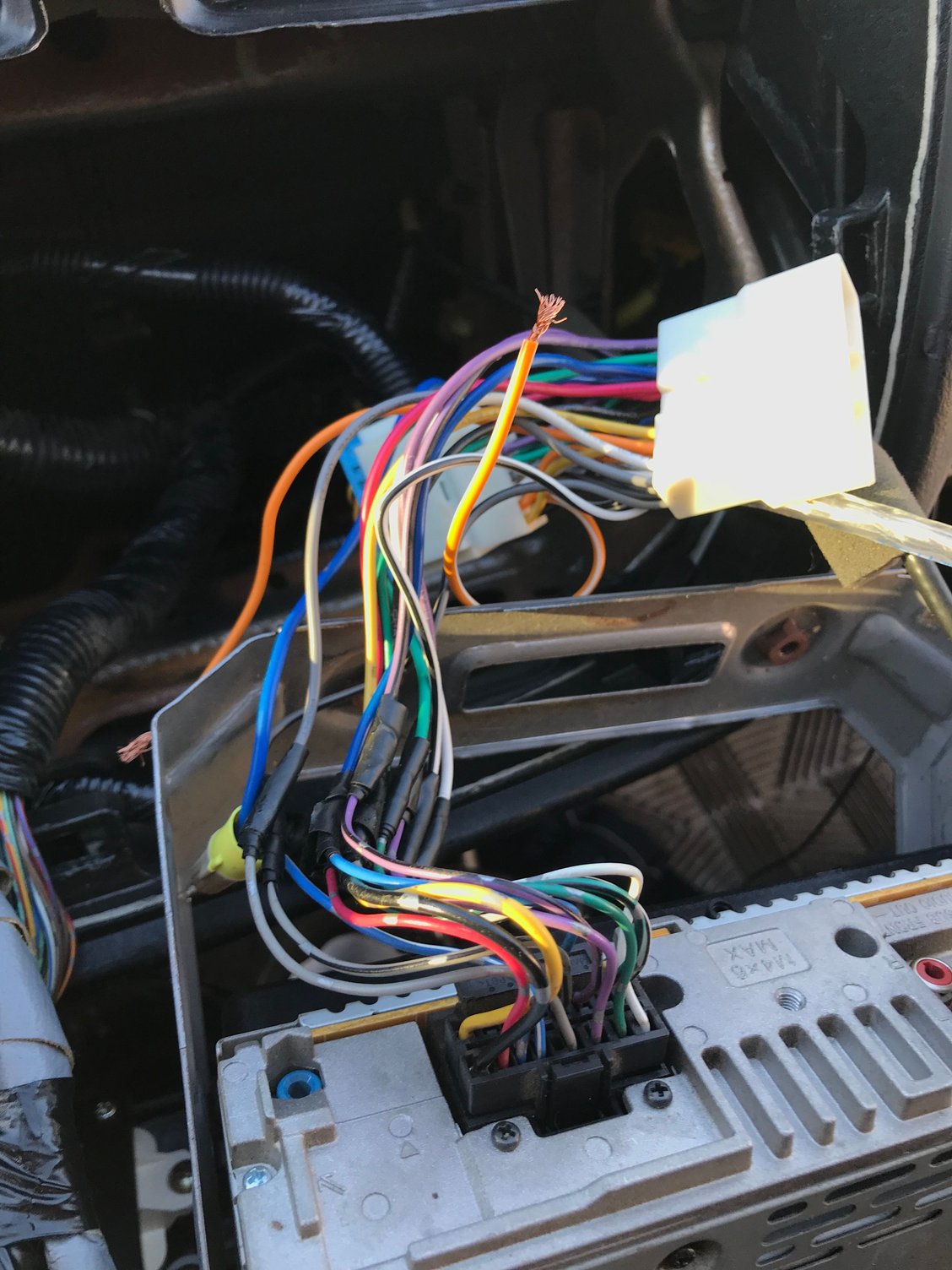

Hello all, so this issue started about 10 days ago on my 2005 civic lx manual. So the problem I’m having is my tail lights, center console lights, liscense plate light and tone that tells you that your lights are on do not work. I remember taking out my center console around the time this happened because I was changing where my rca’s for my sub were running.
It kinda sounds like an issue with whatever switch goes from the **** on the light handle.
Some stuff that isn’t affected by it, is the gauge cluster lights, aftermarket radio, head lights, interior dome lighting, door locks, reverse lights, brake lights, turn signals or window switches.
I would appreciate any help you guys have for this, I’m kinda green with all the electrical stuff but have access to a DMM if that can help.
Here are some pictures with the car running and the lights on.

Some aftermarket stereos have an dash illumination circuit that when hooked up to the car can cause issues. Unplug this connections on the back of head unit if present and see if that helps.
Better if you could show the back of the head unit and the connections you made to the hook it up to the car so other audiophiles (unlike me) can help you out.

for sure, I’ll go do that. Something else that doesn’t work is the lights that flash when I lock or unlock the car. Not sure if this assists a diagnosis in any way. But it figured it’s worth a try.

Get rid of that marrette and make a proper connection. do you have 4 wires in that?
also tape up the ends of those orange wires so that the bare copper can't touch anything

That wire is my remote turn on for my sub. There’s no problem with any of that stuff, these problems have only started about 10 days ago. I’ve had the setup with the radio in the car for about a year and a half with no issues. But I’ll tape off the wires and all.

Check the #2 (15A) fuse in the Under-Hood Fuse/Relay Box. It protects the following circuits:
  1. Audio Unit.
  2. Dash Lights.
  3. Front Parking Lights.
  4. Front Side Marker Lights.
  5. Heater Control Panel.
  6. Inner Taillights.
  7. License Plate Lights
  8. Taillights
