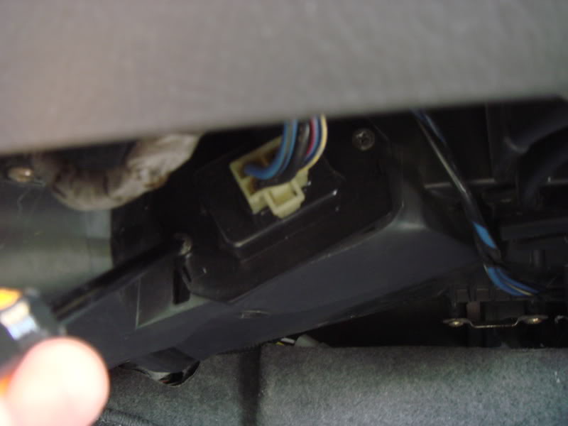

Hmm. See we checked that one and swapped it with another one, but still no go... I called Honda and they said that my car doesn't have a blower motor relay???
All I know is that the motor does work, and that we jumped it to the battery and it turned on. But there is no power getting to this clip:
EDIT: Pic too small lol.
New pic - Name:  DSC02625.jpg
Name:	blower motor clip.jpg

bugout57 is an unknown quantity at this point
Re: Blower Motor Relay
Well, I dont know how to test it, it is a sealed unit with nothing exposed but the male connectors and the aluminum plate things, no reset button or anything, unless that is a different component? I'm not much of an electrician, so this stuff is all Japanese to me. (pun intended, lol). Do the TCO's reside inside the Transistor? Or are they a separate component residing somewhere else? I can always cancel my order if there is a better way to fix it. Thanks,
Sam
To the best of my knowledge (common problem for 7th gens) never messed with mine though.
The TCO has a 114 degree C rating... this is what I read and never got a 100% confirmation. It is a silver .25-.375" x .25" round tube with wire leads at each end. The part is not expensive but locating one quickly and cheaply could be a challenge.
