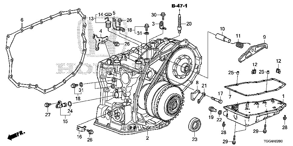

The spill hole (check plug) is also (supposed to be) the fill hole.....but there is a rubber plug on top of the trans that is fairly covered up....it is possible to use that location to add fluid, use a funnel to do so. If I can remember, I might get a pic of it sometime.

I know myself well enough to know I'm not going to remember to take a picture, so here's an image from an online parts catalog....The rubber plug I was talking about is #13

#13 is the fill plug and #33(your pic) #?(mine) is the check fluid hole? I don't want to diminish your janitorial duties; however, I detect an old skool service manager lurking here. Congrats again for the info; I am honored by your presence. Wait, I think I have the wrong year CVT pic!

In my pic #13 can be used as the fill plug, #33 is the check (or spill) plug, but I don't think your pic is quite the same.
Your pic appears to be a different trans version? It doesn't look like an exact match. Different car? What car and where did you look it up?
