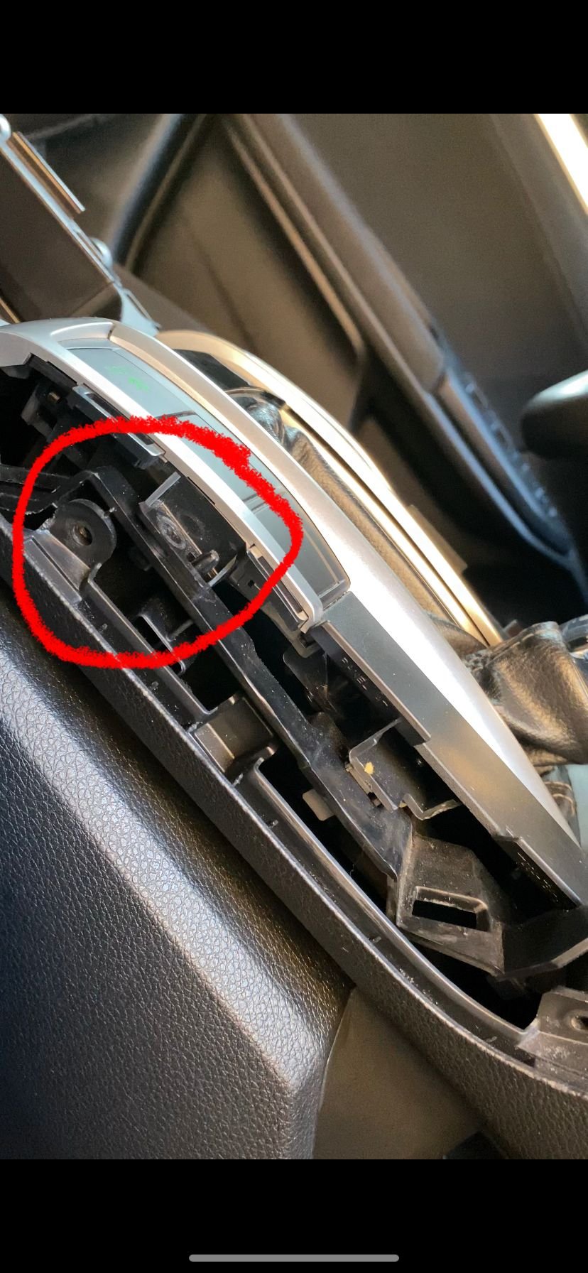

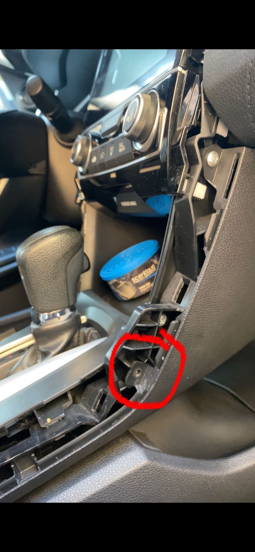

I brought a used 2017 Honda Civic and the center console looked a bit loose to me. After taking off the trims I notice it’s missing some screws . I try to identify the screws online but I can’t. Definitely need some help identifying them.

They're M4 X 16 tapping screws
Honda part number 93913-14420 if you wanna buy OEM.
They're gonna be tough to find in stores if you're in the US. Closest you'll likely find in stores is #8x⅝", and they're gonna be a bit fatter and shorter. I'm not even 100% on there being ⅝" length tapping screws at like.. home Depot or Lowes. Your closest bet may be #8x½"
Local u-pull-it-junkyard.
