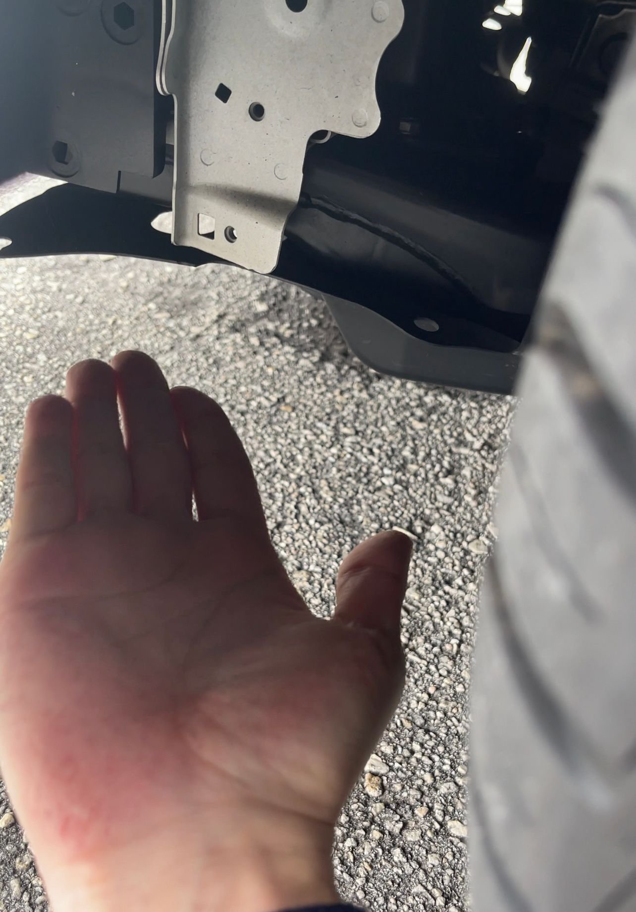

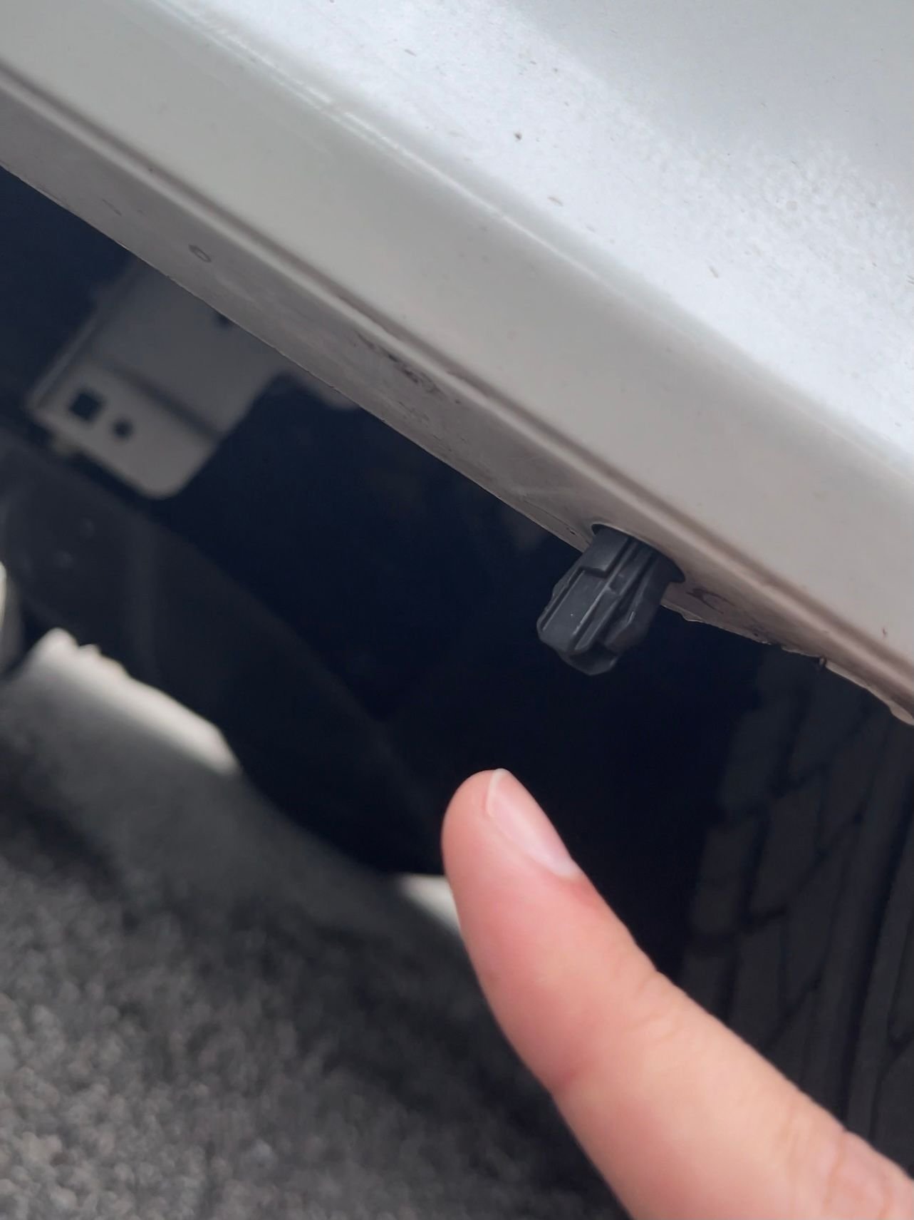

Hey everyone, I’m looking for the name or number of the panel missing from under the front bumper, drivers side.
2021 Honda Civic Hatchback Sport
This is where I think the panel attaches to the bumper on the drivers side
This is right in front of the drivers side tire

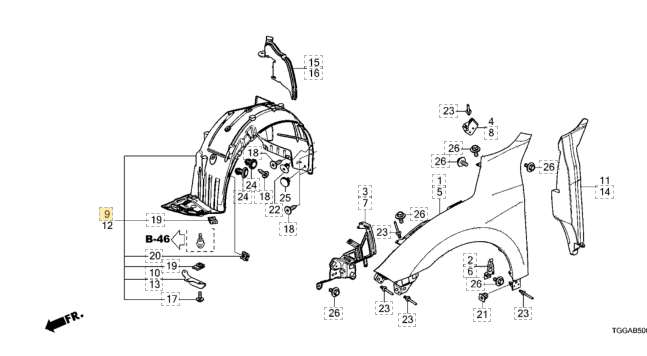

Like in the link above, Honda parts sites have catalogs you can view. Using HondaPartsNow.com, under "Body/Air Conditioning" then "Front Fenders", I see a fender liner. This liner goes all the way around the underside of the fender. Is that what you're missing? Part number 74151-TGG-A70.
