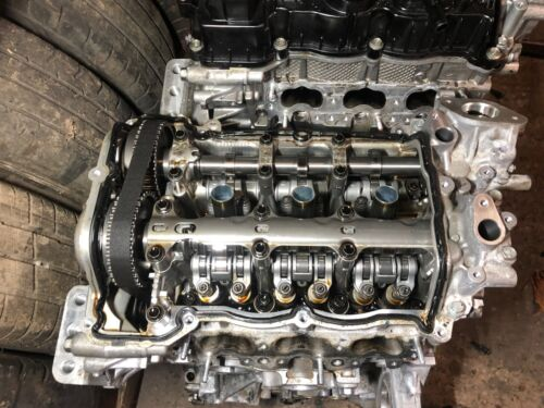

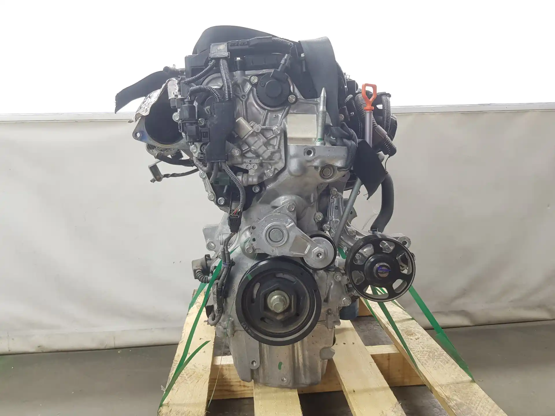

I think I found good pics to illustrate the two
Here's the timing belt, visible if you remove the valve cover
and this side profile, you can see the crank pulley and alternator pulley (and what looks to be the auto-tensioner). I saw some other pics with an ac compressor, too
