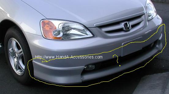

This?
Edit:
Yep, this is what they call the underspoiler eh, and side spoiler haha
Theres no clips... its held on by 5 bolts and 3 self tapping screws and two sides of adheasive tape.
You have to check out why did it come off, like did the bolt bracket come off, etc.

Umm you guys are wrong
The black piece is called an AIR DAM
The picture I attached is called a UNDERSPOILER
*Well acording to Honda*
By the way, I got proof on that IAMFOB!
So is it the black peice (which I bet it is)?

hmm..i just went by the name in the DIY....they called it a spoiler...oh well, at least other ppl knew what i was talking about...
yay
ya, i have always thought those things in ur pic were called front lips...
i'll go try and put it on now...either that or just yank it off...
thanks for all your help guys!
yayya, i have always thought those things in ur pic were called front lips...
Slowly remove it and put it in the garage.
Just to verify, I checked my sources and indeed
The "LIP" under the Bumper are called UNDER SPOILER (The Plastic Piece)
and that the "UNDER SPOILER" are called RUBBER AIR DAM. (The Black Rubber Piece)
Only the LX Sport come in a bundle with under spoiler 'sport' (skirts) kit
The rest of the models are optional...
I guess we learned something new!

The underspoiler is held by 5 bolts and 3 self tapping screws, if it came off than most likely a bolt got popped off.
The last few posts I have made were in correction to the parts name, but I do agree there were irrevelent information posted in regards to the main question.
but my question is...how easy is it to slip it back on without jacks? it's only partially off...so can i just try to find the grooves and push it back in or would it be easier to take off both sides and then slip the black thingy back on?
Since the ground clearance with no load on a Civic is around 140mm... there should be no problem slipping underneath the front end to install back the rubber air dam but than you would need to know what to look for (the slot where it clips in). It would probably be easier to find the groves and push it in as oppose to pull it off and do it... Why not just take off the front bumper and install it from there
Originally posted by watewate
it's much more of a hassle to take off the bumper.... have you done this before? I have, and well, you can easily do it your thumb, pushing the strip into the groove.
Remove Bumper:
- Remove the four clips along the top of the bumper
- Remove the six clips along the bottom of the bumper
- At each fenderwell, remove the self tapping screw.
- With the help of an assistant, gently pull out on each side near the headlight to release the three retaining tabs.
I guess jacking up would be easier.
14CM is alot of room to manuever underneath the vehicle!
Originally posted by AzimuthX
Nope but it sounds so easily lol
Remove Bumper:
Remove Bumper:
Originally posted by Booohahaha
no she means the black rubber piece thats supposed to prevent the under neath of the bumper from scratching hahaha..
i took mine off a long time ago.. but u can just force it back into place if u still have it.. no biggie...just get down there and push it back in!!
whatever, man. CLIPS break, SCREWS can get lost, c'mon, gimme a break here, does it look like babychai has a friend who would help her remove the bumer?
But forget removing it, I would just crawl under and push it back in..

don't need jacks...... just make sure you can get your hands under the bumper.......... it's only 3 or 4 clips that hold it on.......... take off all of them and slide it back into place then reinstall and tighten the clips......

hey guys, thanks for the help!
the screw/clip fell off and i lost it somewhere...
i essentially just tried to nudge the thing back on slowly inch by inch like watewate said...it stayed for a while and then there were some holes so i had this crappy piece of string (my resources are limited in waterloo) and i tried to tie to the bumper, but the string broke, but in the end, it is now held by a straw tied around the holes...hahaha...
i just need that combination to hold until i get back to toronto tm..
i'm going to either jack up the car and remove "the black thingy" completely or go to the dealership and try to buy a clip...
siguy: thanks..i know who to ask if it essentially breaks
thanks to all who read/replied in the thread...
