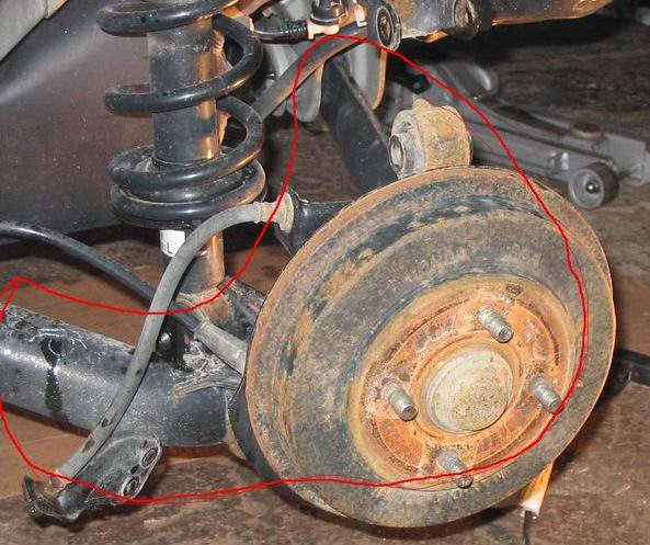

He got more than is needed though. He paid $600 for the full rear control arms, with everything still assembled on them. Makes the job a quick easy install (I know, because I bought them off him). I just dropped the old control arm, and lifted the new one in place. The hardest part was running the e-brake cables. The driver side one is a VERY snug fit.

you don't really need to change anything as far as the resevoir, or master cylinder. The only thing you might want to do is get a brake proportioning valve. It adjusts the brake bias. But I don't really think Its necessary. I havn't AutoX with it yet, so maybe once I do that I'll change my mind, but for normal driving its pretty good.
I bought mine off someone else (he took them off when he sold his car), so I don't really know where he got them. Its some honda parts distributor in Montreal or something. All it is is the whole rear control arm from a SiR w/brakes and cables still attached. Then its just a straight bolt in, except the cables. I just snipped the ABS sensor wires. Also, because you have a 01LX (no rear sway bar), if you do it this way you get the rear mounting points for a swaybar on the new SiR parts. definitely a plus!!
