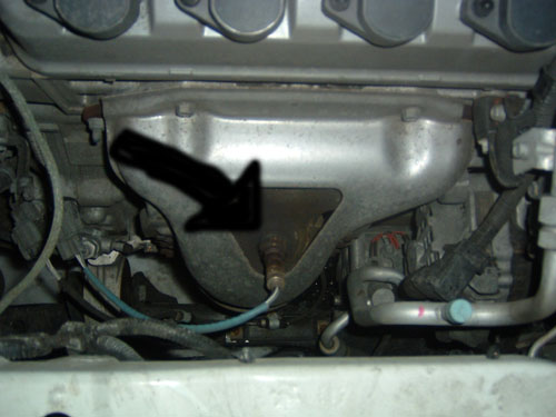

ppl with Hp headers... where do the o2 sensor go on the Hp header? ... where is it located?
or ppl with different aftermarket headers... where is the o2 sensor located?
like Dc sports or kamikaze to name a few examples............
or if you guys relocated... where did you or the mechanics relocated it to?
as the pic below, where the arrow is pointing.. that's the o2 sensor, right?

You must extend the O2 sensor about 14-16 inches to be able to reach the O2 bung on the bottom of the header...

Sorry i'm replying so late, just got back from work, night shift. Yup, that's the 02 sensor in your pic. I had to relocate the 02 sensors to the bottom of the car, one before and one after the cat. I have the HP top portion, custom downpipe, hi flo cat, and cat back exhaust.

the pic i have up... that black wire next to the blue'ish colour.. is that the other o2 sensor? or you/mechanic added another one?

the pic i have up is a stock lx header.
so it should be different to your dc header.
.. did you install your dc header yourself>? i think the o2 sensor is in a different location for the Si. i dont remember.. havent looked under the hood of a Si in a while.

I have the 01 LX, there are 2 O2 sensors on the exhuast, first one from your picture, the second one is after the cat. converter...You will need to extend the 2nd O2 sensor if you plan to get an aftermarket high-flow cat. converter...
