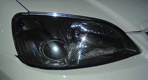

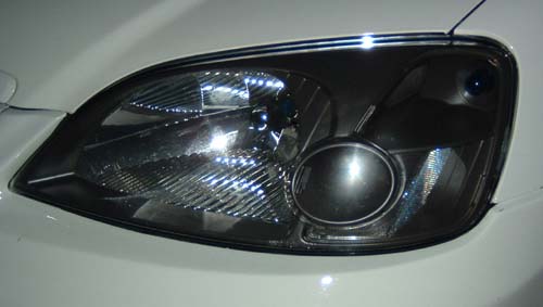

i've taken my headlights apart twice.
first time was last fall season.. to clear my headlights.
second time was a month ago to do blackhousing. the paint colour aint exactly black.. its called "iron... case or something along those lines" ... its from cdn. tires.... like this colour over the black. viclx has it on his car as well.
i was gonna do whitehousing.. but went black first.. if i get tired of it, maybe white next year.
as for moisture or fogging... none whatsoever.... i just reused the type of glue it was on it originally... some type of windshield glue? ... well, and all i did was use silicone to reseal the sides...s o no air would get it.

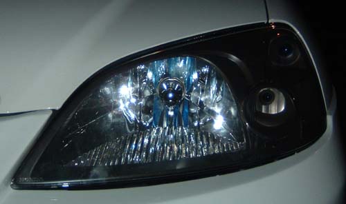

oh ya.. one more thing. around the turning signal area........ there's some type of reflector design so when your turn signal flashs... it makes it appear bright so other cars can see it.
i painted mine over 'cause i tried to cover it with masking tape.. but it was such a b i t ch doing it.. so id idnt bother and just painted over it.
the turn signal now... doesnt appear to be as bright whne it flashes while you have a turning signal on.......... it's still noticable... but slighty.. haha, but i dont care. as long as it flashes.
What kind of bulbs are you using in those pics? I love the blue reflection on the inner chrome piece.
Old Oct 19, 2003
TeLLy's Avatar
Yes, it's an Acura EL
iTrader: (23)
Posts: 8,248
Hey nitehawk, most of the aftermarket "hyperwhite" bulbs available reflect blue like that. I use Showoff Kryptons myself.
