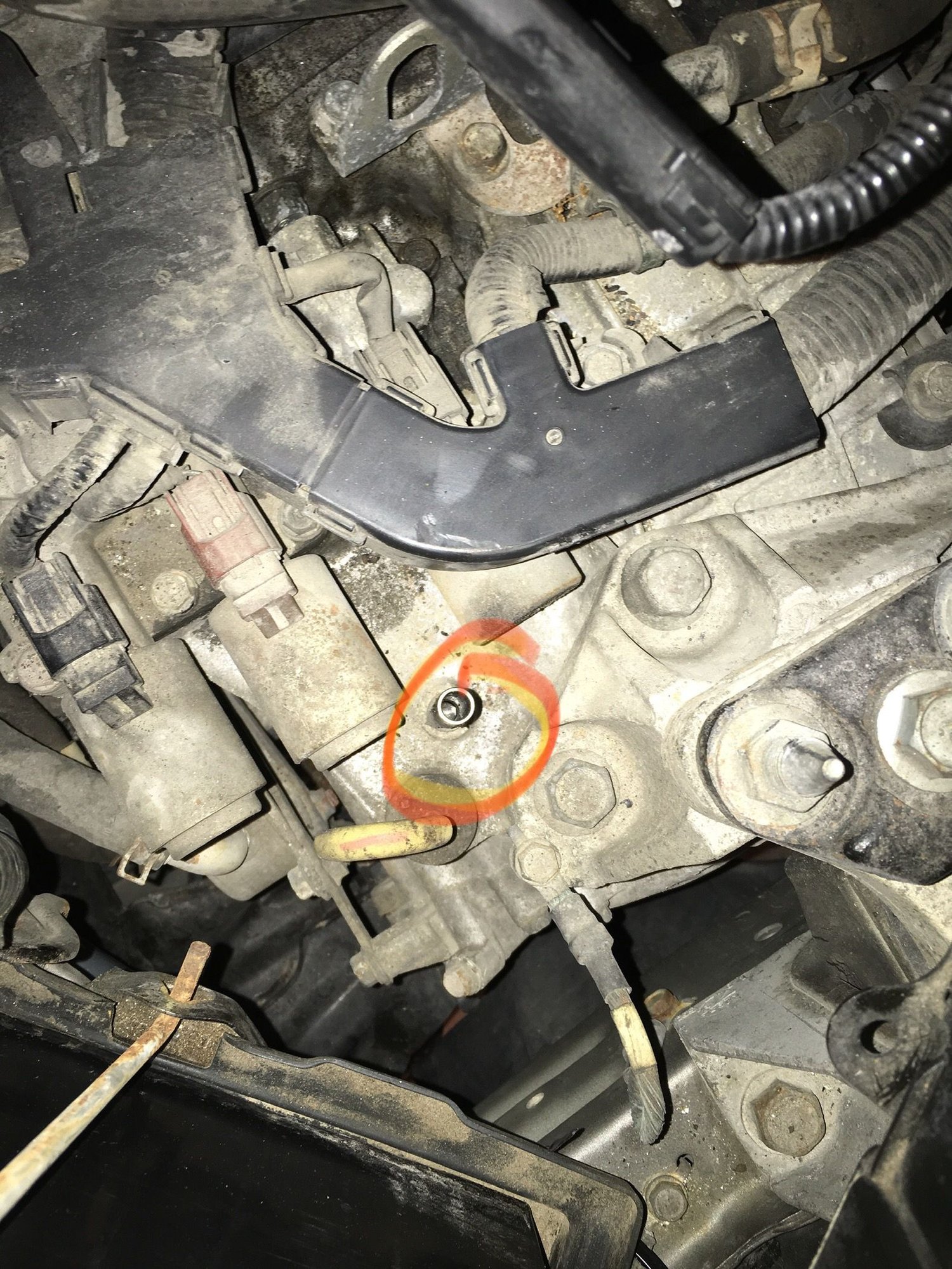

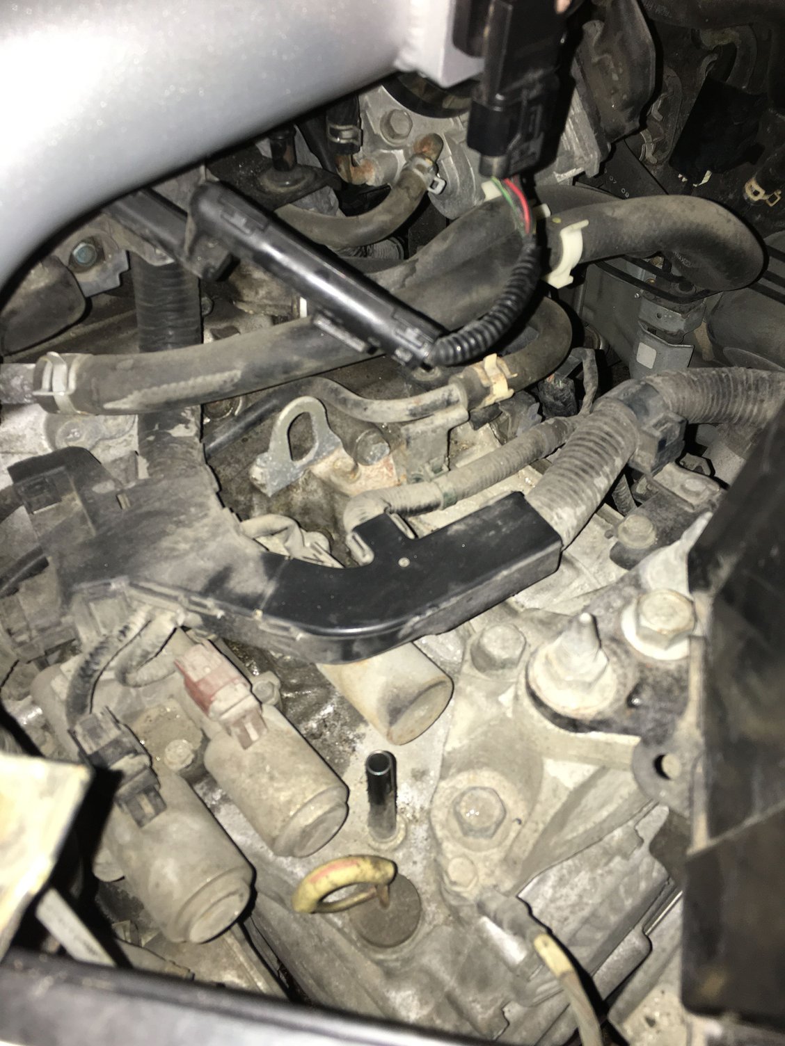

Just installed our sons first mod. A DC sports cold air intake . My question... now that I removed the old air box , there is a “milkshake” straw size tube in the area of the transmission dipstick . This Open tube must have had the Air box on it as I found a small hole in the air box I believe was for this. Now that the box is gone, what is this tube and do I need to cover it? Thanks for any
help in advance !

That's the vent tube for the trans, there's supposed to be a little cap on it. Go to the dealer

He just started his 4hr drive back to college and will not return until Friday and no Honda dealers close to us. I will have to order. Will it be ok to drive until Friday without the cap? Thank you for the response!

Try to avoid puddles and dirt/dusty roads.
should probably check condition of the trans fluid to see if it needs to be changed

Does autozone, advance or Oreilys have these available ? His school town does have these stores if they have the part. Thanks again

They could order it in, but I’d be surprised if they had one in stock.

Thanks! I will tell him to limit his driving until Friday and pick one up at a dealership about an hr from me. When returns for college Friday, I will snap it in! Hopefully no problems happen while it isn’t covered😬
