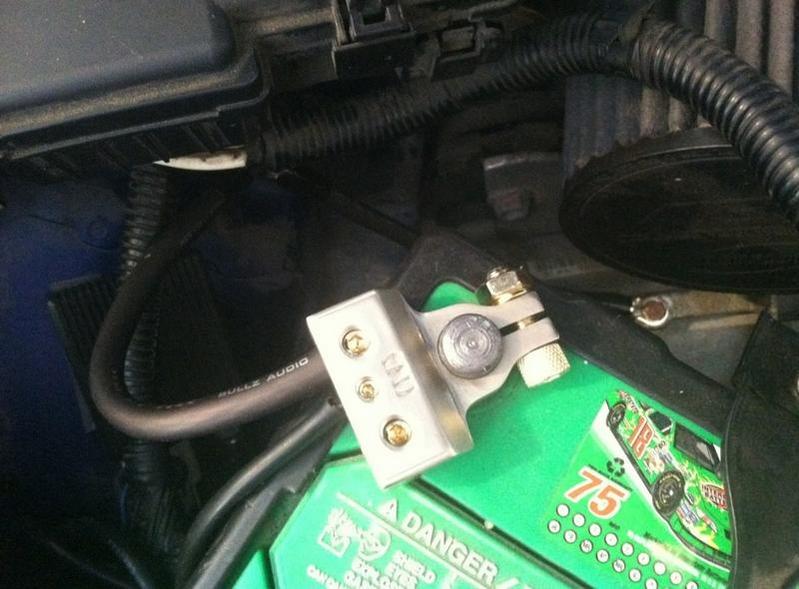

This is what I have.
The larger diameter is the ground, the smaller one is the stock terminal connection that had to be spliced into the clamp because my old terminal was very badly corroded.

Those connections are solid.
Not sure how you got dirt underneath....

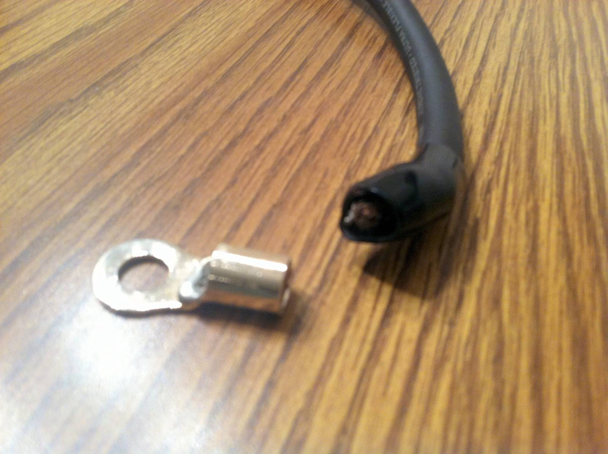

Finally a conclusive answer to all my startin' problems!!!
I really hate to point fingers, but Kenny... this is all your fault......
I think the dealers may have "accidentally" bumped the connection back into place and thought they fixed everything. WRONG. After not starting 6 times today, I dug in again and found the culprit was the ground wire between the engine block and the frame. The solder was busted and the wires free to move around inside. So I went mad with a propane torch and a bunch of solder and packed it full Now it all starts up in under 1 second again!
The HIDs kinda work better now (the drivers side even better than before, lol) but the passenger still side cuts out. I'll swap ballast on Friday because I'll bet that is the problem.
I learned the hard way Kenny. You better check our grounds too before the same thing happens to you

Crimp, not solder. Or crimp first, THEN solder.
At least that explains some of the other weird sounding descriptions you have.
Who removed perfectly fine ground straps the factory had in there, and replaced them with crap?

Actually the stock ground from the same spot was almost entirely corroded through. You could almost break it with a pinch of the fingers.
All the other joints are really good on these, but the solder at this joint barely reached into the wiring. Yes, they were crimped before soldered.
That eyelet in the fuzzy pic above doesn't look crimped, that's why I said that. (Maybe it's just fuzzy?) If it had been crimped (well), it shouldn't have been able to pull out of the eyelet.
Just a bad picture. It was definitely crimped. If you don't believe me, just ask kennykid, lol

They weren't exactly crimped.
I don't have a crimp tool for that size.
They were folded up on each other.
I made sure all connections were snug and tight.
Had it wrung up on a pole, and tugged on it with at least 10lbs of force.
Made sure they were sturdy before sending em off.
Not sure how you (or the dealer) broke the solder off.

Have you seen the metal eating s**t they put on the streets here?
Everything rusts here. EVERTYTHING. And that are above the grille tends to be problematic. I'm not saying that's the main cause, but that entire terminal was solid brown underneath. Also the bolt holding in the connection may have been too tight and twisted and torqued the wire till it hit breaking point.

Possibly, and the engine moves around in there, so it may have tugged on that wire too hard.
But it still doesn't explain your headlight problem

Ahhh, good point. With the wire slightly twisted, the vibration of the motor could've been tugging on it until it finely broke loose.
The headlight thing, LOL, I dunno what's up. Now they both come on at first but the passenger cuts out after 10 seconds. Like I said, I will tests the ballasts on Friday.
