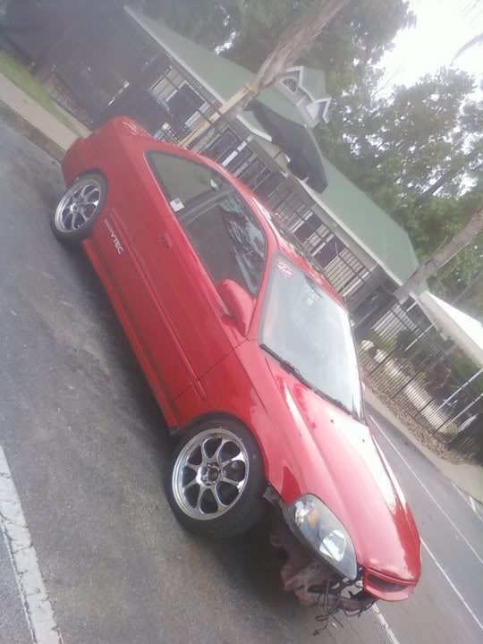

Until this happened

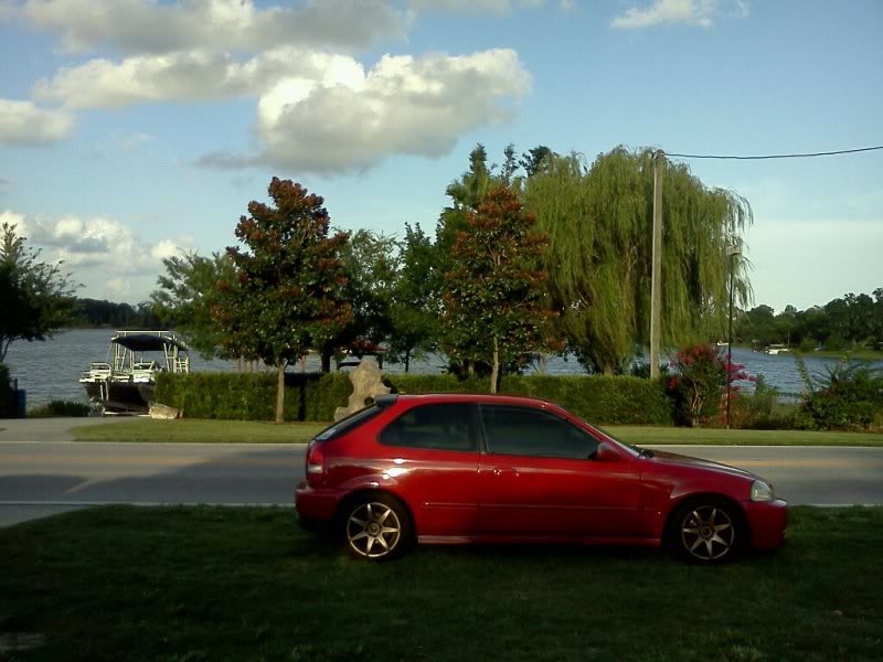

So I bought this

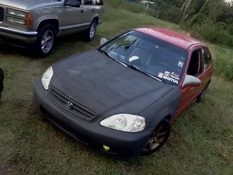

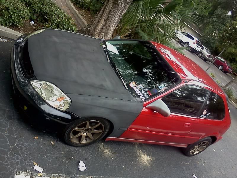

but I absolutely HATE the 96-98 front end so I did this.

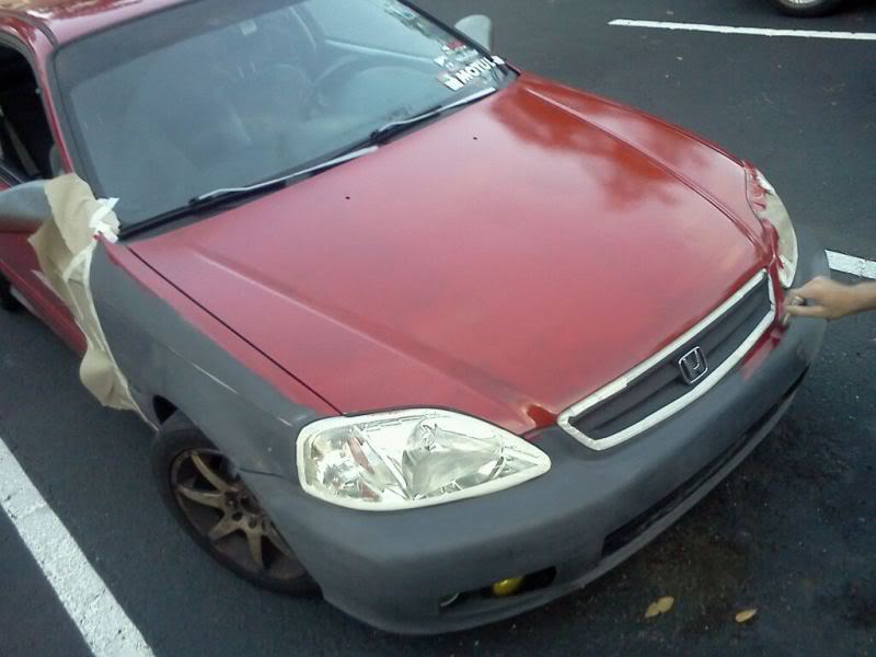

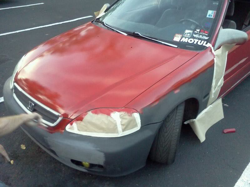

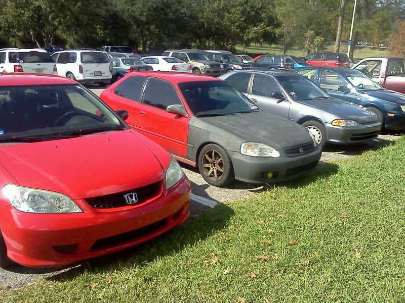

But I got tired of the two tone. So I started painting. Today I got the first coat down. I've spent less than $30 so far.

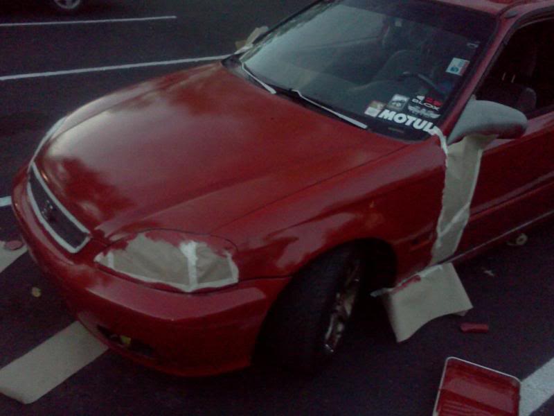

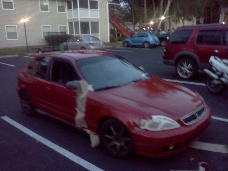

This is how it sits now. I ran out of daylight. Tomorrow after class I'll be sanding and putting down another coat. Looking good so far

I used less than a quart of Rustoleum red paint and decided to roll it on instead of spray it for several reasons. I'll have more pictures up tomorrow.

Good move on the 99-00 front end, that's a huge improvement. I'm looking forward to seeing the results, I don't want to go rustoleum on my car, but I do want to attempt re-spraying myself..
What wheels are those?

I picked rustoleum because it was the closest match to my paint. Nobody could match it because it is so red. Its Roma Red, a pain in the *** to find.
The Si had Racing hart CP8Rs that I polished up
The hatch has Sportmaxx 786 that I rattle canned bronze.

ur pre-painted hatch looks like my car. lol

Roma Red and everything?! Great minds look alike man

hahah no no.
i went back to stock on my front end. so from the door and back, its painted oem, and from the fenders, hood, bumper...its primed. lol
ill get the whole car painted sooner or later

I'm debating on going back to that tbh. Why you might ask? I'm glad you did
I would like to point out right now, how much I adimately DESPISE the Roma Red factory paint color. The reason being that it is IMPOSSIBLE to match. It is. Seriously. No lie. I checked on it first thing this morning and the paint dried a different color. Completely. I'm talking about Fire Engine Red vs Ketchup red, its a HUGE difference. Now I either have to finish painting it and be two tone again which I don't want to do, or paint the whole ****ing car which again, I don't want to do.
At this point, I'm faced with either finish it, go back to primer black, or do the whole car.

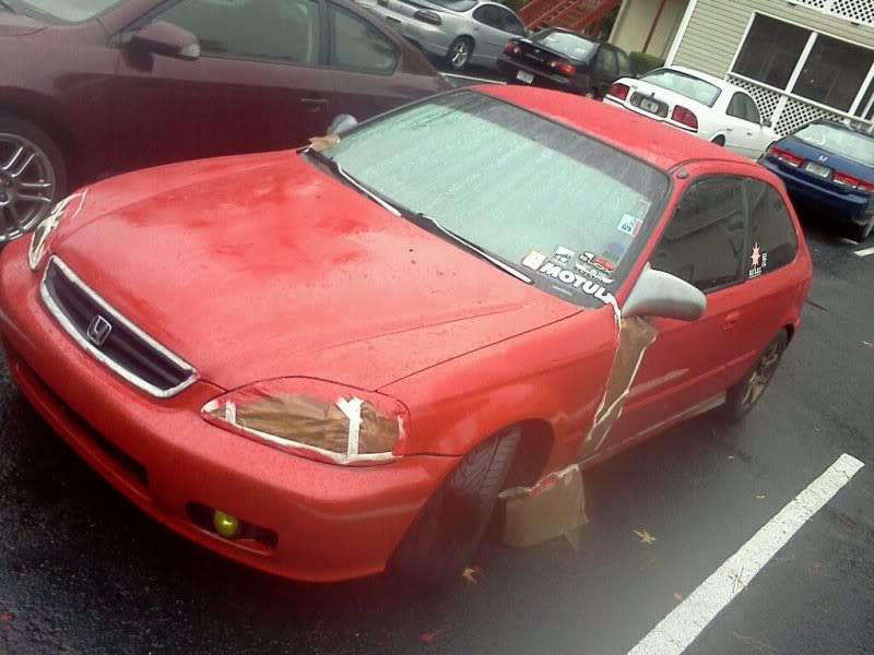

So everyone has heard the song singing in the rain? I made up a new one called sanding in the rain. I needed to wet sand the first coat to put a second coat on today and it's been raining all day. At first I was pissed BUTT i figured why not go out and sand in the rain. It's ghetto as fehk but then again, I'm painting my car in my parking lot with house paint and a paint roller....it wouldn't be beneath me would it. So I went out in the rain and started wet sanding and let mother nature do the rest. A bunch of the paint ran off into a puddle and this STUPID ducks (they don't move for moving cars, I bump into them with my GFs car all the time hahahaha) walked in it so they now have bright red feed mwahahaha this is what its at so far.
paint looks dull because ive sanded it with 340 grit until smooth. The paint doesn't match but it looks damn good man. I will say that. Ironically, it matches Milano Red exactly. IIIIIIIIRONY. So it will look like a 99-00 Milano Red front clip on a hatch. Not too bad until I get around to painting it. I can deal with it for now until I can get the money to get it done with matching paint. It's better than it being black and everyone asking if I got in an accident. Ill post up more pics when I get another coat down.

ahahahaha
Props for painting in a parking lot (I do the same), wet sanding in the rain, and dying ducks feet red.

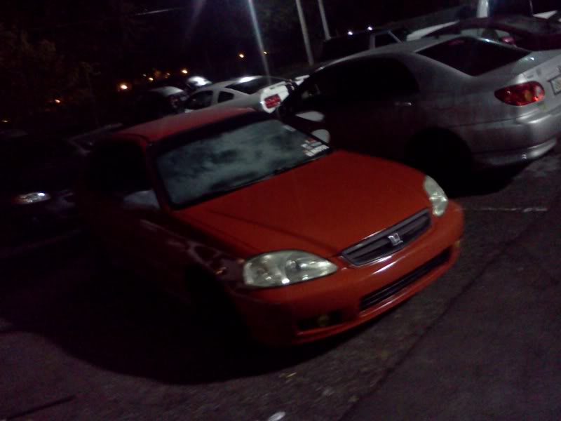

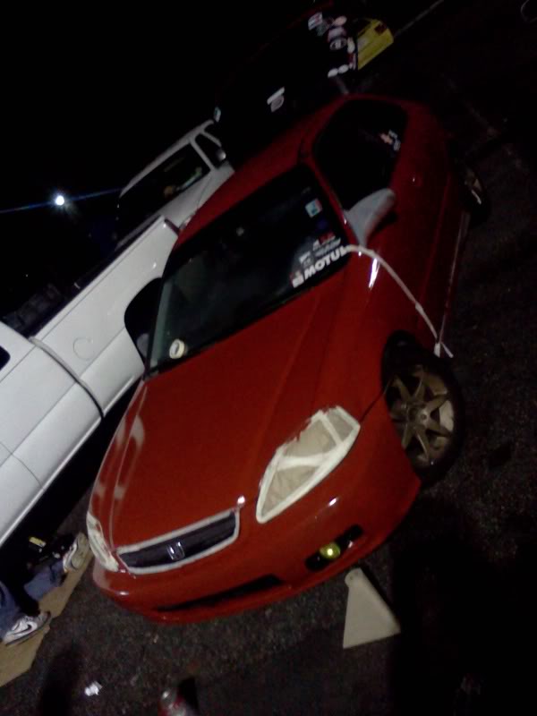

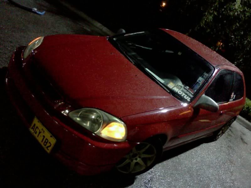

^I just have terrible luck with spraying lol I hate all the prep involved with spraying and the clear coating. I just wanted to have this on as a temp fix until I get the fundage to have it professionally matched and sprayed. If this stays for over a year, I can't complain man, I mean seriously, $30 and it looks damn good. It will look a whole lot better when I buff it after it cures. but thar she blows. Ill get better photos when its daytime

Not too shabby for 30 dollas. i need to do the mirrors grille and side skirts next.

coming form someone who has a soon to be career tht cooks them.
and riot, thats is freaking awesome for a "$30" paint job. did u rattle it?
when i rattled my bike, it took almost $150+ in rattle cans from primer, base to clear.
no suh, I used one quart of Rustoleum red (that I thought matched my paint) an aluminum paint tray and two ultra smooth finish high density rollers. With tax and everything and sand paper and such it came out to 27 and some pennies at Lowe's, we built something together. For yall other peeps out there with less obnoxious colors than Roma Red you can do what I did initially, pop your bumper trim piece off of the fender, the ones that run along the side of the car, and take it into the paint department, ask them to match that color. To yall with metallic colors, well yall are pretty much fehked since I don't see how yall can roll on metallic paint, but for the rest of yall, yall can thin the ***** out of a gallon of rustoleum or any other exterior paint and feed it through a gravity gun or a wagner power sprayer and do it that way with matched paint.

did u primer it or just base coat it? did you clear coat it as well?

holy ****. i jsut realized u did one of those roller paint jobs... VERY NICE MAN.
ive always wanted to try something like this out but never had to *****...but with my car showing it's age, i seriously might have to consider this.

if it comes out horribly, its nothing that sand paper an spray paint can't fix. As far as prep goes, I had spray primer under it, I just scuffed it up with some 340 lightly and rolled it on and then 340 on the first coat and rolled on a second and done. Im going out now to see how it dried before I decide if it needs a clear. Ill snap some photos

I did rustoleum paint job before,
It comes out good only with a lot of sanding and a couple layers of clear

dude i give you mad props. nice front end conversion, looks waay better, and DAMN that roller paint job looks sooooo good for $30! nice job man
