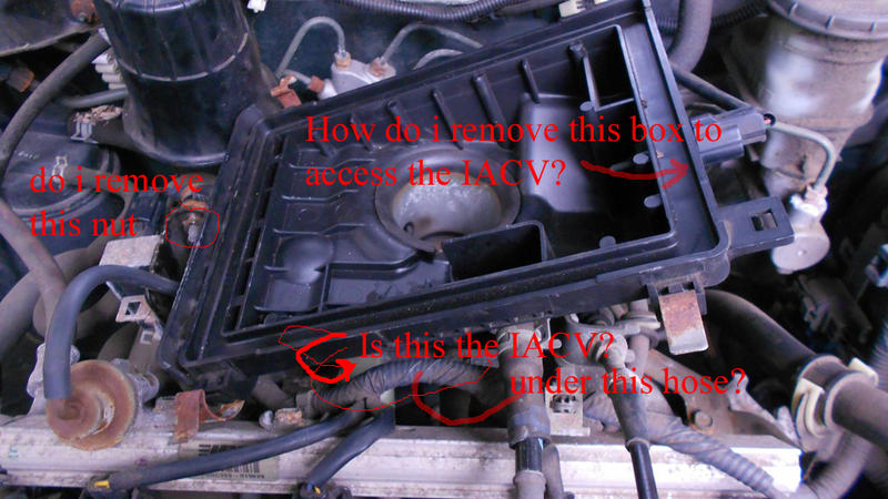

My mechanic advised me that I needed a new IACV. The idle was jumping from 1 to 2 so I took it for a diagnosis. The cost...$500. After reading other IACV posts I tried removing the Air Cleaner box but I'm having trouble identifying which screws to remove to enable me to lift the air cleaner box off. There is also a large clamp underneath the box that looks like it needs to be removed to get the box off, however, I can't access it. I'm posting a picture showing my 99 Civic LX engine. Can someone please shed light on how to get this box off the throttle. I think I've ID'd where the actual IACV. Thank YOU!!

Looks like a sensor connected to the right side that needs to be removed. There should also be a clamp that connects the air box to the throttle body... it's under the big plastic housing. Here's a diagram of how it is put on:
http://estore.honda.com/honda/parts/...n=&b=B++01&dl=
The IACV should look like this:
http://www.ebay.com/itm/New-Control-Idle-Air-Control-Valve-Fit-For-Honda-Civic-1996-2000-1Pcs-/321191714451?pt=Motors_Car_Truck_Parts_Accessories&fits=Year%3A1999%7CModel%3ACivic&hash=item4ac8849e93&vxp=mtr#ht_3076wt_1003

It's all figured out and repaired. Thank You
