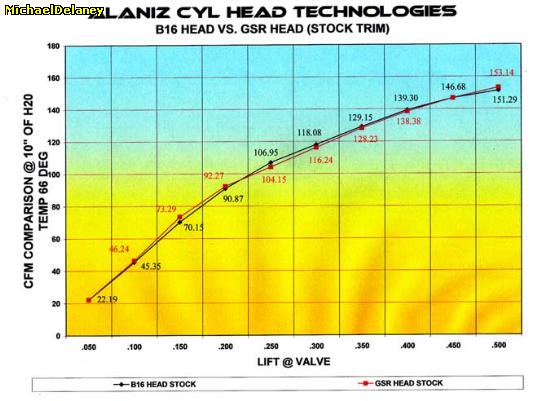

Originally Posted by truegrit0
what does a b16a head do for a b18c1 engine?
b16 heads are said to flow better. also in combination with a b16 tranny, you get closer gear ratios. most ef-eg-ek enthusiast know about this setup and is commonly used.
A b16 head doesn't flow any better then a gsr b18 head. The gsr actually flows better slightly. I b16 is basically a slightly destroke b18c1.
He would actually lose static compression if he put a b16 head on a b18c1 block.
If he's staying NA, then the only thing he would gain would be using if the SI tranny.
if he's going boost then a b18c1 would be a better plateform to start with since the tranny is already gear well for turbo and the stock head can hold a lot of power already.
stock b16 head vs stock b18c1 head
THere's more info on the differences on this thread
http://www.team-integra.net/forum/di...1&ThreadPage=1
