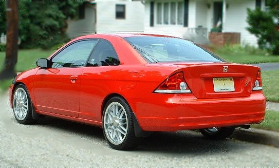

Some specific stuff:
2001-2003 coupes have pair of small, extra lights that 2004/2005 coupes dont use, so just take the bulb off and tape up the end of the harness.
There is one hole on the 2004/2005 taillamps that is different size than the 2001-2003s (I cant remember if it's for the turn signal or the brake). If you want to fix it right, order a pair of the new sockets and bulbs. Other members have trimmed the old harness to fit it.
It's been a while since i took them off, but here's mine
(yes they're 2004 taillights, except modified a little)
