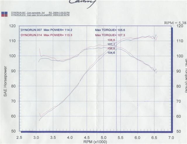

I cannot imagine how many ppl are thinking D17 engages VTEC at 4500+ rpm.
Read more article before posting any reply on this. Read the VTEC tuning articles, especially on where a VTEC engagement point is supposed to be tuned. If you read carefully, you should find something reads "VTEC engagement point should be set at the initial torque drop point".
Here we go, we have a 16 lobe camshaft vs. 20 lobe camshaft in older VTEC. What it really means is, it is built on the concept of VTEC-E. Building on VTEC-E doesn't mean no power, but means VTEC engages at fairly LOW rpm, and pressure sensing is incorporated into the system. By the definition of VTEC tuning, a 12 valve operation will end its torque output at around 3000rpm, which it has a first peak torque before 3000rpm. Next, it will have the high cam torque peak, for the 16 valve operation. So it actually has 2 peaks for D17. Do a dyno from 1000rpm on you will see. Doing it from 3000rpm just ignored the first peak. I see this because I actually asked the dyno guy to do from 2000rpm, then I read the graph.
Also, if any of you is posting torque/hp curve please have a torque/hp curve crossed at 5250rpm or it won't make any sense to read it.

This entire post doesn't even apply to the D17 Civic.
There is only ONE STAGE VTEC in the D17 EX engine. This is NOT a VTEC-E ENGINE!! NOR is it a 3 stage VTEC engine.
it's just plain old SOHC VTEC. all valves are open at all times on the D17 civic and there is only 2 cam profiles on the cams, which enable the intake valves to open for greater duration when the hi-cam profile kicks in.
As for VTEC tuning and when VTEC should kick in, the point that you should engage the hi-cam is when the low-cam profile could no longer produce an air/fuel flow efficient enough to support the engine vs what the hi-cam can produce. In other words, utilizing the low-cam profile as much as possible for low end air/fuel flow until it would be more efficient to use the hi-cam profile.
Now, THIS REPLY was directly from one of the technicians at the dyno shop where Hondata does their R&D. And as I said, we will soon have the definite answer as to when exactly the D17 civic engages the hi-cam profile during closed loop operation.

The tech you mention above isnt really telling us anything we dont already know.
