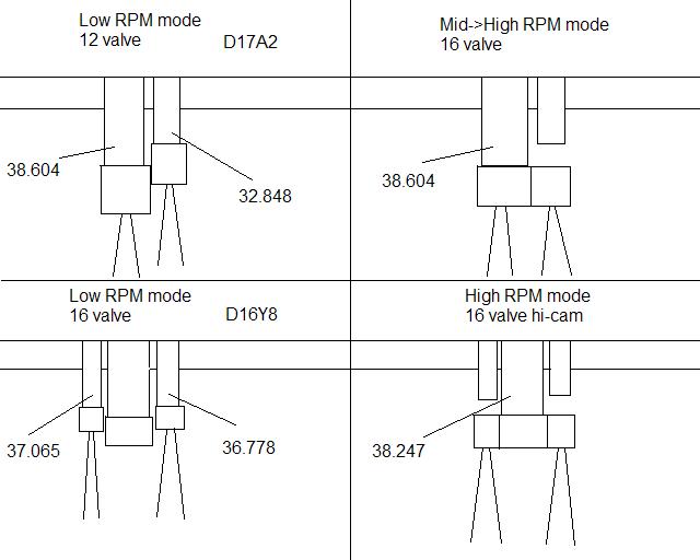

I know that there's been a lot of confusion about our VTEC. After a long period of confusion and examination about parts, and look at other people's opinion, the result comes up.

The main difference between D17A2 and older VTEC is, the older VTEC has 3 lobes per cylinder, and 2 of them are for regular 16 valve operation. The thrid high-cam engages at about 4500RPM so that it creates more power, and the jolt is felt.
D17A2 uses 2 lobes per cylinder, which is like VTEC-E without lean burn, that at low RPM there's only 12 valve mode. However, take a look at the profile, the "operating" low RPM intake cam is actually a "high-cam" compared to the old VTEC. This way, in contrast, our engine becomes VTEC hybrid instead of VTEC-E. (By definintion, VTEC-E is a lean burn engine, otherwise the E has no meaning.) We can still call that VTEC-E, but it does not mean to be a VTEC-E.
The only difference is, because of the 2 different profile of lobe(which in volume is a little smaller than D16Y8's low cam mode), more torque is generated. And, since the engine will operate at 16 valve mode, it is the same as moving the high-cam to engage all the way down to around 3000RPM. Therefore the car is much more smooth than D16Y8, and you don't feel the jolt when VTEC kicks in.

If you want fun, then the ordinary VTEC(like DOHC VTEC or at least D16Y8) will be better because of the jolt and sudden pull. But in terms of performance and riding comfort, D17A2 is better because of the smooth transition between low and high cam and the nice straight HP curve. Remember the last time you or your friend went to the shop with ordinary VTEC to tune for a nice straight curve(to maximize power to the whole powerband)? How hard was it(note the jump from non-VTEC to VTEC)?

And guys, sorry for the horrible drawing. I wish I have some professional CAD software to draw it but i don't.

I think the D17A2 setup is a better arrangement for low-end torque and high-end horsepower. Basically you will want 2 very low profile lobe to start with, but if the profile doesn't change, it will kill the high-end horsepower. If you have 2 high-cam engaged at low RPM, then you kill the torque.
But in fact, if we have VTEC controller, we should delay the VTEC engagement point for D17. I will explain it later.

In reality, any VTEC engines smaller than 2.0L are using 1 normal lobe and 1 flatter lobe at low RPM. I got the data from B16A2, the low-mid RPM lobe are 33.088 and 34.978, about 2mm difference. In fact, this arrangement will generate better torque at low speed. At high RPM, the 36.267 lobe kicks in, then there's the pull. Our engines actually breath better at low RPM than B16A all the way to about 4000RPM (It is always true for SOHC engines that at low RPM SOHC breath better).
Our engine's design is good so that at low RPM, it seems like it is running at 12 valve, but in terms with volume, without lean burn, it is running just as good as 16 valve(the longer lobe actually induce alot more air to the cylinder). However the engine's VTEC engagement is too low so that it doesn't perform the best it can. I would suggest to change the engagement point to run it as an ordinary VTEC, to engage about 3500~4500 RPM would make it a little better.

It's the deal. Looking back to the first picture, the D17 design come from an original VTEC-E engine, which is 12 valve at low RPM and 16 valve at high RPM. The D17A6(HX) engine also has a high lobe and low lobe that is ALMOST the same profile with the D17A2(EX) engine. Therefore theroretically the EX engine becomes a VTEC-E.
But in real life, D17A6 is a lean-burn engine, D17A2 is not. So comparing D17A2 and the old D16Y8(ordinary VTEC) there's no difference at high RPM(high lobe), except that D17A2 engages hi-cam earlier. So it is a TRUE VTEC engine.
VTEC-E and true VTEC adds up to be a VTEC hybrid. But we can call it either VTEC-E or VTEC.

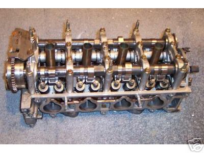

Here's the proof of "black" DOHC i-VTEC.
Take a look at the intake side(at the buttom) and exhaust side.
