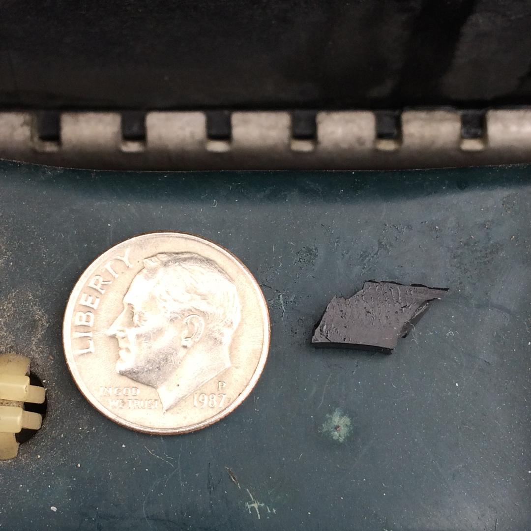

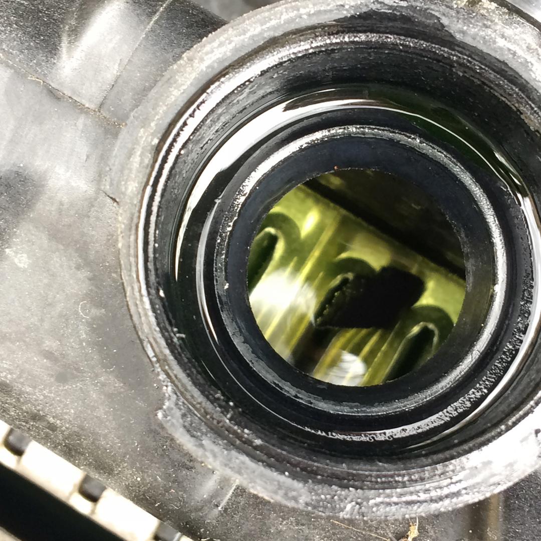

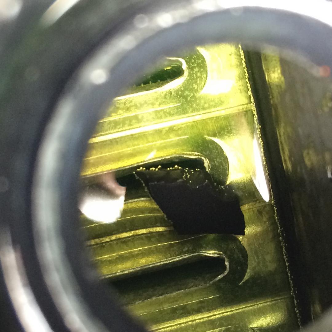

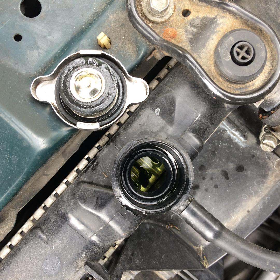

I noticed that the coolant level was dropping inside the radiator. I would just add a little more coolant. There were no visible leaks. Yesterday, I removed the radiator cap and saw a piece of black rubber floating inside, (see pics).
I removed the piece of rubber, but have no idea where it came from. The rubber seals in the radiator cap are intact and not damaged.
I checked the radiator hoses (which will be replaced) and they weren't damaged.

Replace the radiator cap. Purchase a Honda genuine (OEM) cap from local dealer or certified Honda parts dealer online: such as HondaPartsNow.
After-market caps do not fit as well.

Chunk of thermostat gasket?

Take Ezone's suggestion over mine. Remove and inspect the thermostat gasket first.
Even before that either get the car on a lift while it's running and inspect for leaks or place a large piece of cardboard (size of engine or larger) and run engine for 15 minutes or more to try and locate a possible leak.
