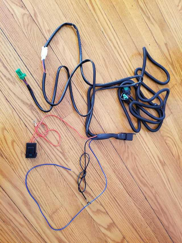

Good day,
I tried to search the forum if I can find the answer and unfortunately I cant find it or either I missed it. I was hoping you guys can help me. So I bought a foglight assembly and Im not sure if Im missing some connectors as the one that I received doesnt look like the same as posted here that bought off Amazon.
Can you guys give me an idea where to connect which one to where? I dont have the brown connector that you can connect to the OEM so i was thinking either I bought a wrong assembly or seller send me a wrong one. Thanks guys for the assistance.

Red wire would go to power, black to ground, the blue wire is the trigger wire. If you want the fog lights to come on with the headlights you will need to splice it into the low beam headlight circuit. Two connectors in the top right are for the fog lights, connector in the top left (I'm assuming) is for a fog light switch. Definitely not an OEM harness.
