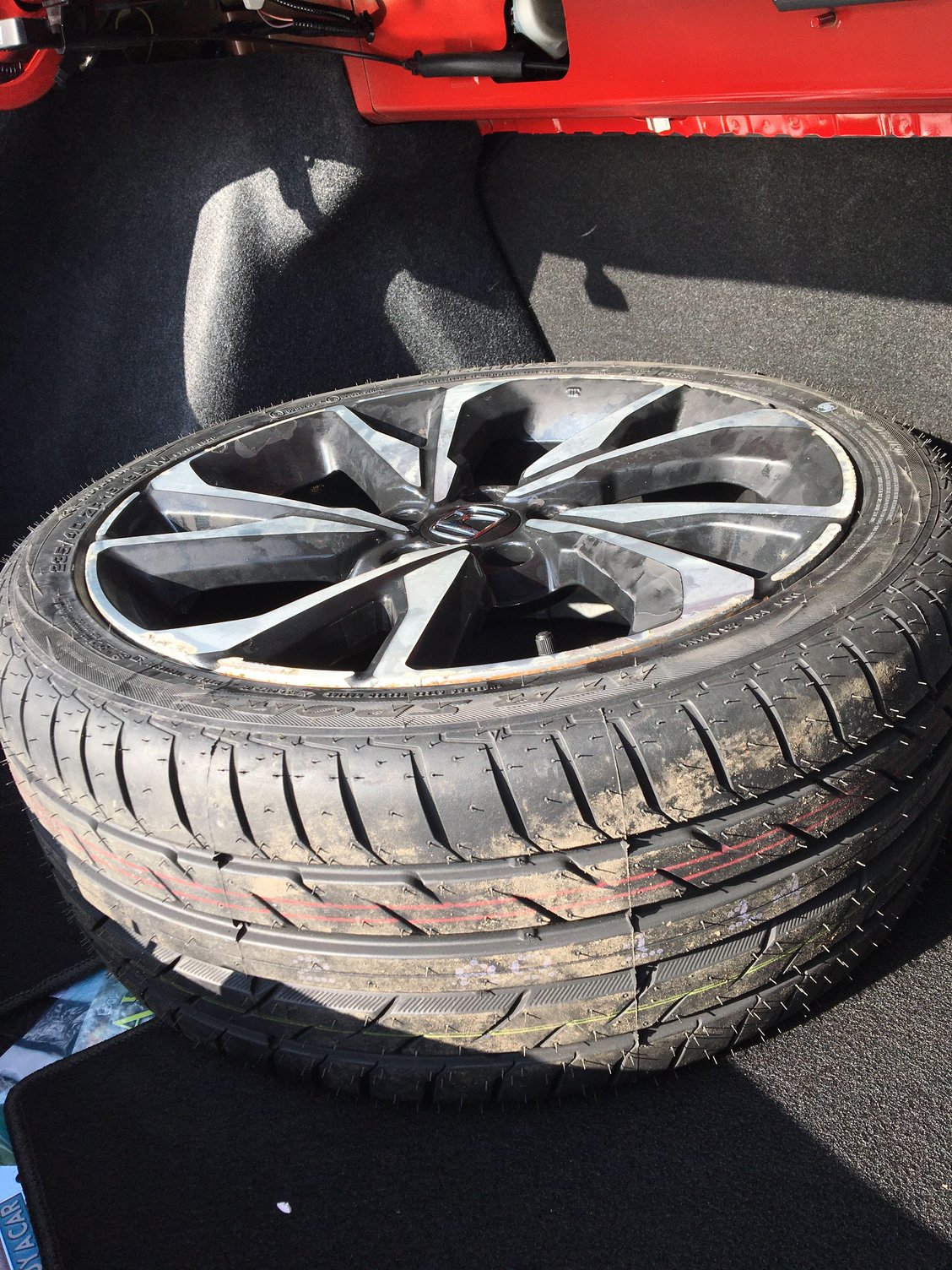

I went with the takeoff factory wheel from a salvage yard.
$270 is a LOT more than I wanted to spend for a wheel and tire I sincerely hope to never need; but it could save the day when bad luck hits...especially if I’m on a trip and don’t want to spend my vacation time calling then waiting then paying for help because I got a flat.
Heads up to anyone else who owns an Si: I found an 18 inch Achilles sport tire for $70 delivered. It got good reviews on Consumer Reports and very positive comments from owners who’ve used this tire on all kinds of cars.
When this car needs tires, I’m going to buy 4 more like this one and rotate them in set of 5, the way people did 40 or so years ago. So even if I never need the spare I’ll still use it.
