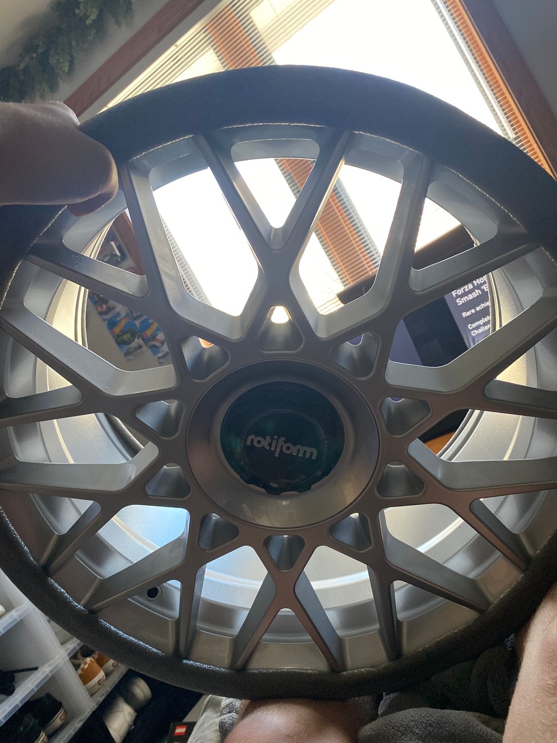

So I recently bought rotiforms in the perfect size I believed for the car after fitting tires and having it back down to its aftermarket ride height it was too low and there wasn’t near enough room and I was running a little. So my options are either swap out my lowering springs for stocks or get strut tower spacers to give myself a little bit more room while not making it look like a monster truck. Is there any good websites/ manufacturers of strut spacers for the front and rear of 21 civics?

again, off-set? tire size? or do you not know them? tire size is stamped into the tire sidewall, go read them
add what lowering springs
also, pics, please

I meant the pics of the car with the tire/wheel...
the sport and sport touring have the 235/35R19 as option
https://tiresize.com/tires/Honda/Civic/2021/
the wheel offset (for the lower rim sizes) is around 45-50
https://www.wheel-size.com/size/honda/civic/2021/
you have the tire one step lower in width, offset seem to be correct...
so i can only say that 2" drop was too much, based on information so far.
