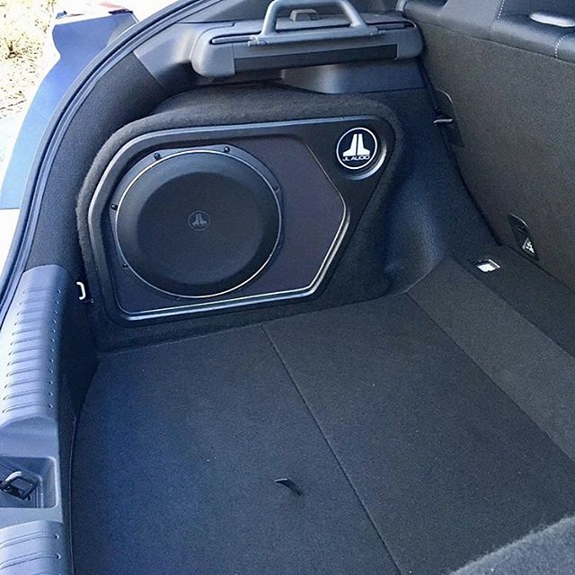

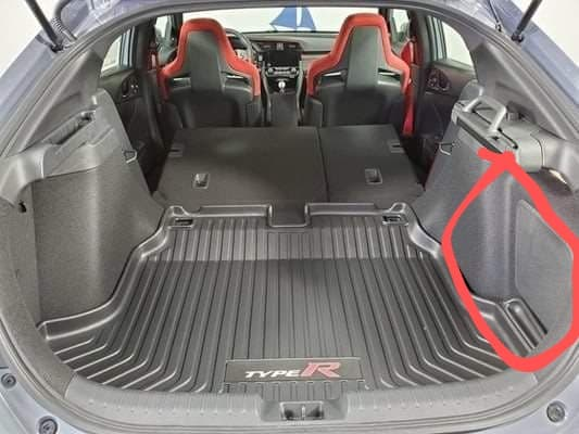

Otherwise, if you want to make an enclosure that takes up the same corner where the OEM sub sits, that's a viable option, too. it does eat up some cargo space though. You would need to modify the spare tire cover so you can still access the spare
Here's how much space the OEM sub takes
and an example of what ppl have done in those back corners. Looks like this dude has subs on both sides judging by the carpet on the bottom right of the pic

Thanks for the pictures. I don’t think I could use the factory woofer spot. Probably not enough space.
I have a Stinger MT7001 amp it’s like 9 by 11 inches. Both fit in the false floor on the left of the spare. I’ll put the amp in the left corner under that flap.
