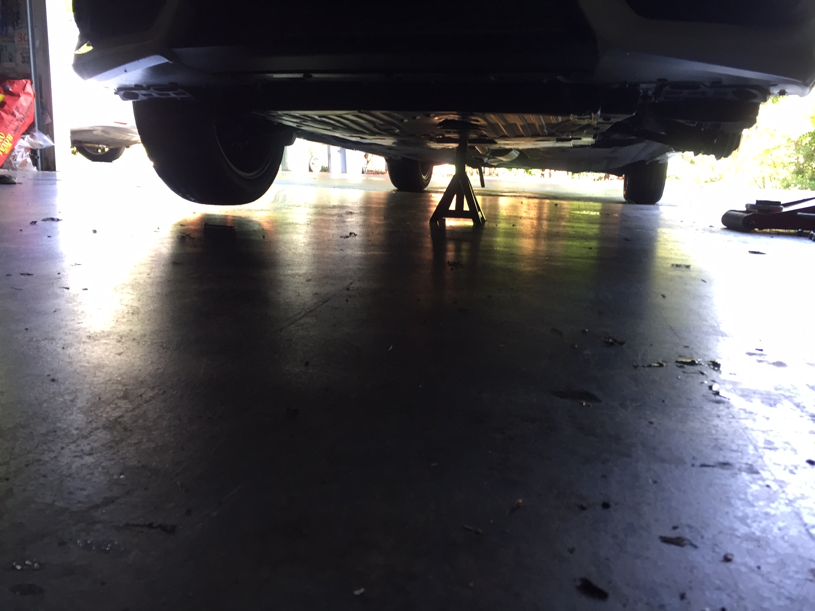

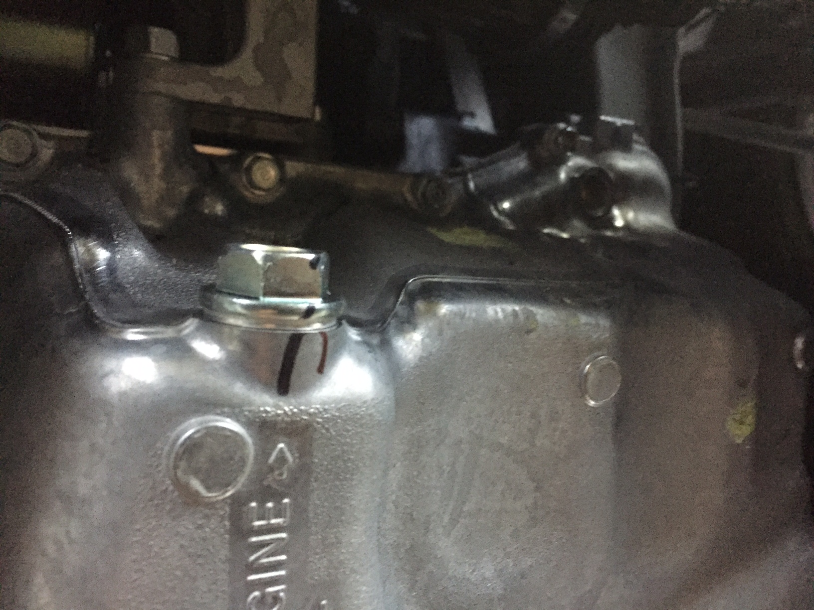

So I jacked up the car today to change wheels and to do my first survey of the underside of the car. As ezone stated, there is a panel underneath the car that has to be removed. It is a bit tedious - there are three types of fasteners that need to be removed. There are two types of Philips head screws (two of each type) and six flat head quarter turn screws. Wear gloves as the panel itself is a thin piece of aluminum and you can cut your hands as you slide the panel off of four slide guides. I can see this becoming tedious as the miles accrue and the fasteners start to get corroded with salt and road debris.
Anyway the oil drain plug is not recessed and is easily accessed once the panel is off; so no adapter is necessary.
The other nuisance is that the central jacking point is far back from the front of the car. Unless you have a very low profile jack, you can't use it as a central lift point to jack up the front and them put stands on the side jack points. I was able to jack up the car high enough from one side and then place a single jack stand under the central lift point, but this is not an optimal solution. This car really needs a lift for servicing.
