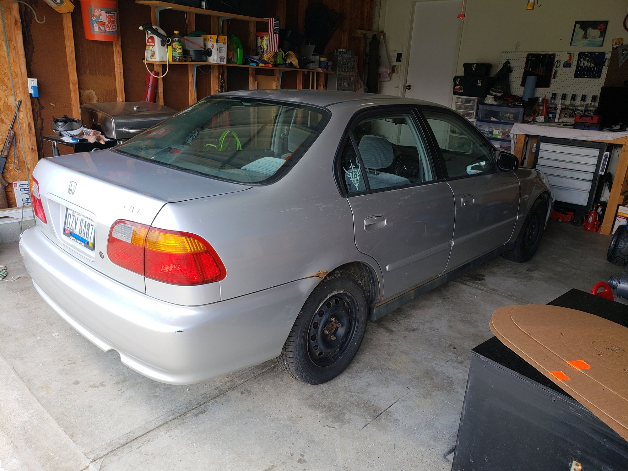

Hey all, I just got a 1998 with 200k+ miles. The vin says it's a "VP" trim. It was two of my younger siblings first cars. My dad said it was overheating so he gave it to me. I just sold my beamer and got a truck, so I plan to tinker with the civic and essentially rebuild it and then use it as a commuter. I have body rust to fix as well as rust everywhere else. Currently I'm looking at replacing the exhaust manifold and entire exhaust system. I'm not trying to dump all kinds of money into this car, just have fun working on it and then use it to commute to work everyday. So, I found headers for 50 bucks, but I can't find an exhaust system I want. I find plenty for right around 100 bucks but I don't want the 4 inch tip in the back. Suggestions? I'm sure I'll be posting a lot in the future. Like I said, doing a lot of this just for the fun of it. Something to tinker with and rebuild.
Any other ideas or advice for something would be appreciated.
Thanks,
Matt
