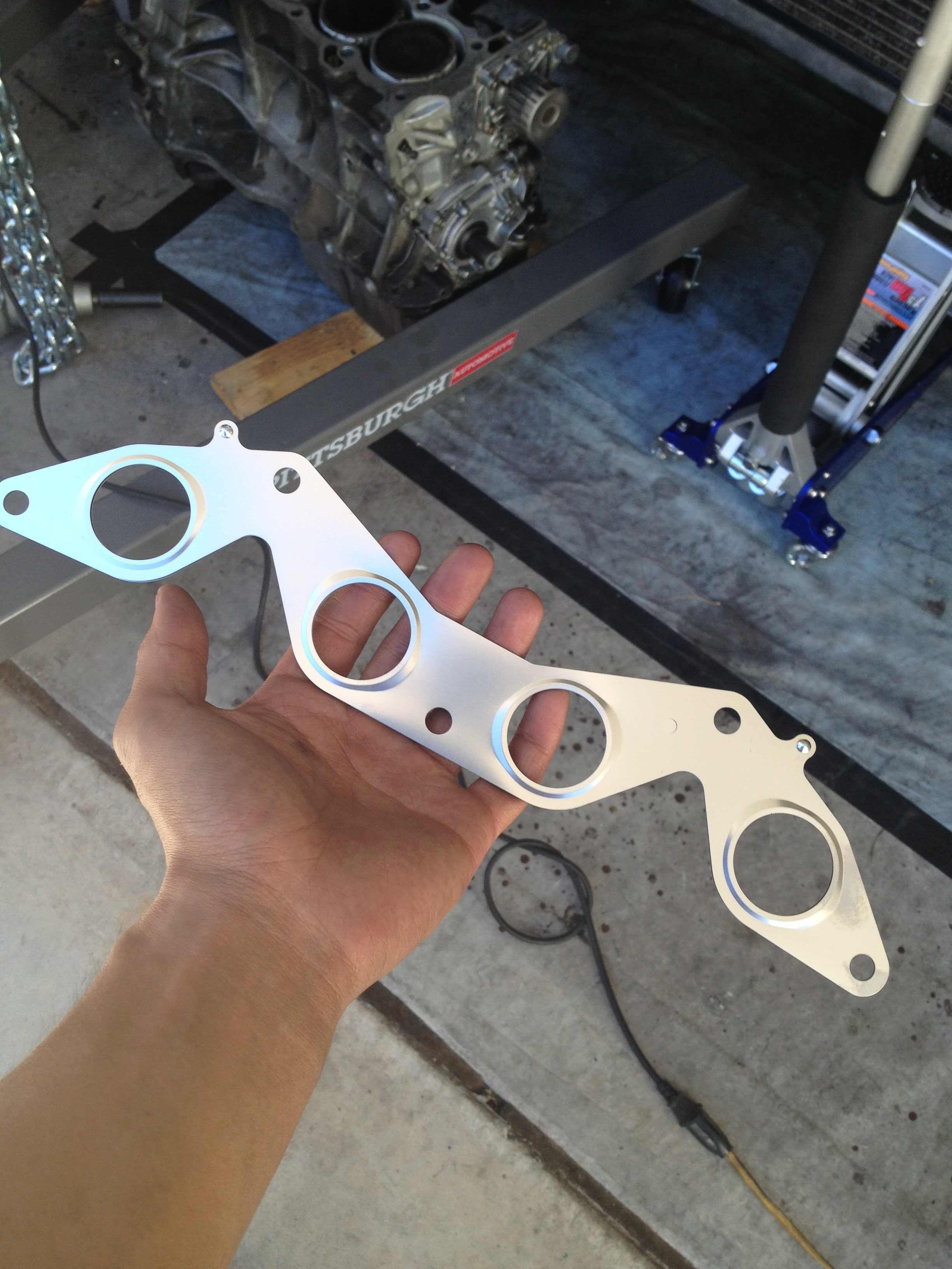

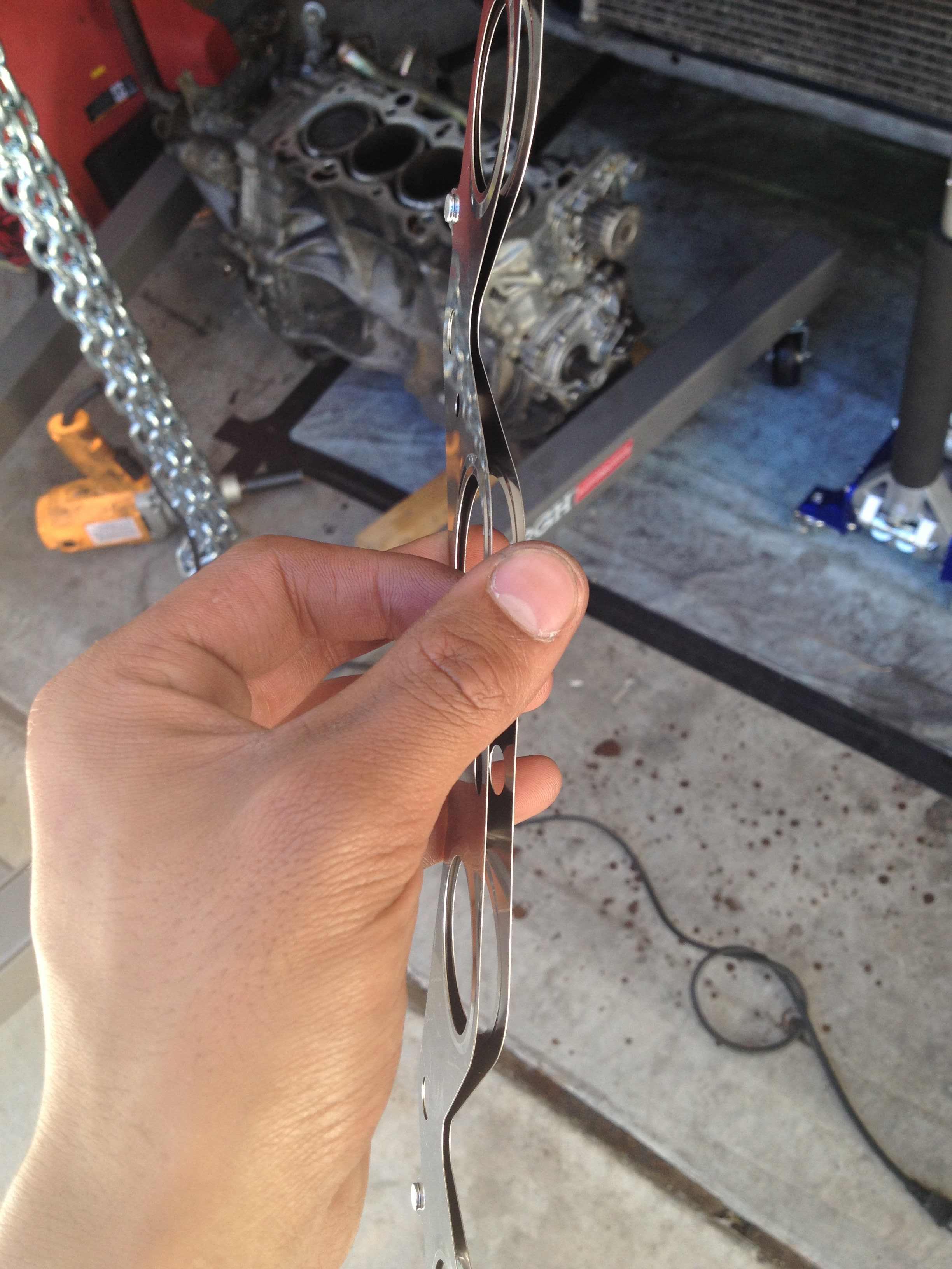

That's all the gasket is suppose to be: thin and metal, likely double layer. Easy to bend. You're not supposed to use silicone or anything to help seal the gasket.
You should have used the new gasket.
Edit: for comparison sake, here's the Honda OEM one I'm gonna put on my car

And to show how thin it is
