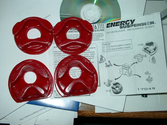

I feel pretty incompetent. I just got the motor mount inserts today. Was able to find 3 out of the 4 mounts. Here's a diagram from www.hondaautomotiveparts.com. I wasn't able to find the one closest to the firewall. I was only able to find the 2 on the sides and the one up front. Does anyone have pics of their motor mount inserts installed?

The 4th motor mount is a liquid filled mount. You can't replace it.

My diagram that came with my mounts said that the two small ones go in the front and my two big ones go behind the engine. I covered up the instructions because of the copyright but left what could be found on www.hondaautomotiveparts.com.
I've heard this will get rid of my wheel hop. If anyone's read one of my old posts, I can't even even launch at 2000RPM without wheelhop. My tires (Yoko AVS ES100) stick pretty well too.
It looks like I won't have to put anything on the side mounts from the instructions.

Okay, I finally got the motor mounts in and here are some of the things that changed.
The car launches better and I'm not sure if I'm imagining this but braking I seem to stop more level.
My car is crazy noisy now. The stiffening is carrying the engine vibration throughout the chassis. I haven't had a chance for someone to rev my engine while I was outside.
Taking turns is pretty much the same except when I accelerate. That part is a little better. Otherwise, my car still turns like crap because of the abuse I've put it through.

If you can get under your car it'll take you a few min for the front. The back ones needed to be trimmed and that took around an hour to get it to the right shape and getting the rear mount off. The rear mount gave my mechanic a bit of trouble as my pipe was sorta in the way and you needed a bit of dexterity to get it out. But he got it back in and my ride takes of like mad. They work. Braking feels a lot more linear too but maybe that's my imagination.
And I found that after having my tires rotated, a lot of the vibrations disappeared too (not all). And my turning is much better. Either my previous front tires were worn, misaligned or had the wrong air pressure but that problem was fixed.
