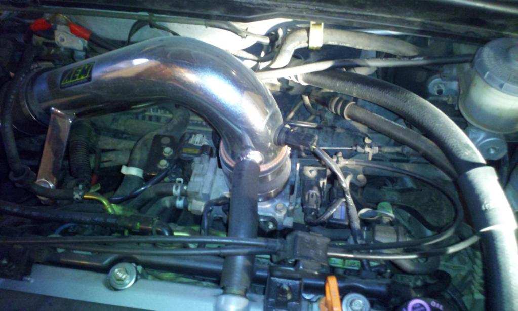

The IAT sensor is the one located to the right of the pcv hose on the tube. You should still have this in your car. It just pulls out of the tube and when the stock air box is on it just pops in the hole there....
