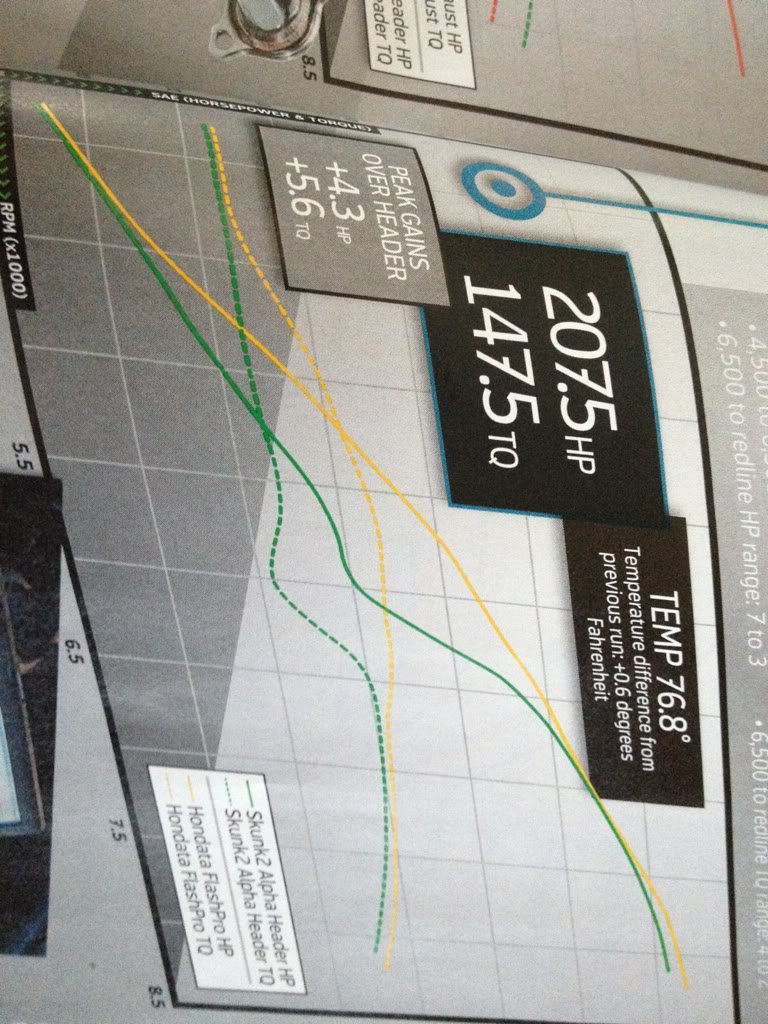

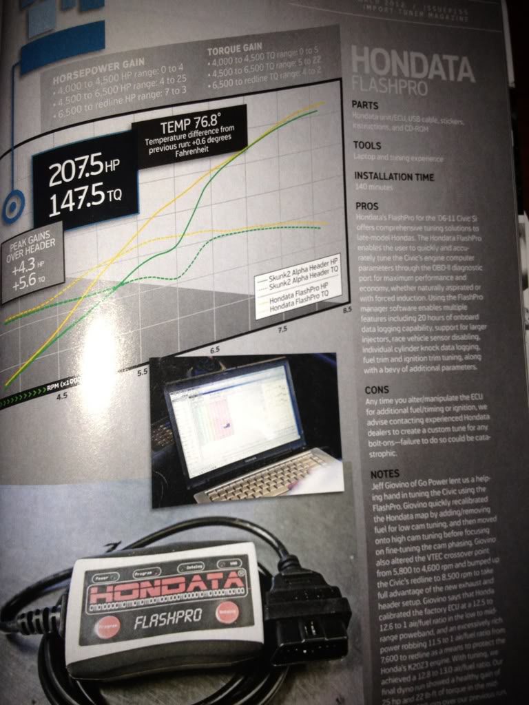

This was done on an 07 Si (with Go Power exhaust, Skunk2 Alpha Header, and Hondata FlashPro)
The gains shown are just FlashPro

Re: computer suggestions? 07 si
wow that seems like a pretty good power gain! my buddy has a mustang all decked out and wanst to race me at the track so im hoping with the flash pro and a tune i have a chance of beating him
