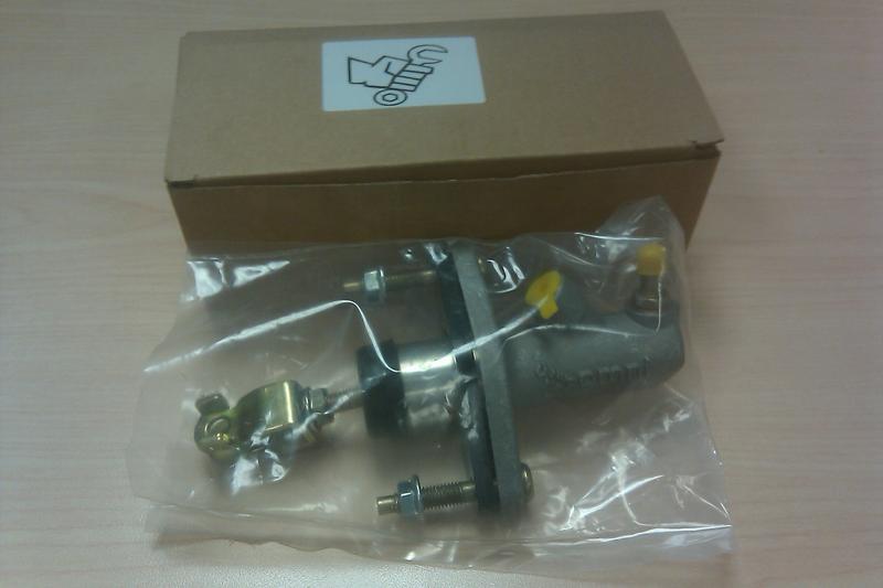

After a long trip away I came home to a clutch pedal that stayed down on the firewall after starting up the car. Spent the the weekend gathering parts for a Clutch Master and Slave Cylinder swap. Theoretically easy, but sort of a pain in the butt. Some thoughts on the swap:
1) An OEM CMC swap should take less than an hour, plus time needed to bleed. This swap took me a day and a half.
2) You can barely see the CMC from the engine bay, it's tucked into a little cubby to the right of the Brake Master Cylinder. You cannot see the CMC from the driver's side wheel well.
3) The supplied braided line for the OMNI Power CMC (which replaces part of the hard line) will not work for EM2s. It's about 36" too short. The line has a banjo fitting on one end with an adapter to couple to the -10 female fitting on the other. The flex line on our EM2s that couples up to the hard line has a -12 female fitting. No bueno. Earl's/Russell do not make a male -12 fitting. Not sure about Aeroquip, but aluminim isn't recommeded for high pressure lines, anyways. We're talking 1500+ PSI.
4) The only way the OMNI Power CMC will work with EM2 is to fabricate a steel braided line (depending on how you route it), approximately 54" to 60" from the CMC to the Slave Cylinder's hard line. I believe I used a 3AN to a -10 female coupler, to tie the braided line and hardline together.

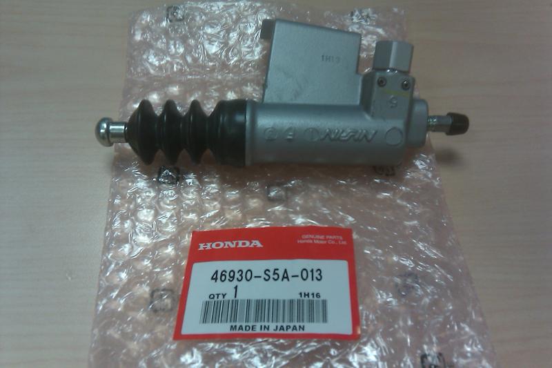

5) The slave cylinder is a piece of cake. 10 minutes to swap.

7) Cost - $150 for the OMNI Power vs. $100 to $120 for a OEM CMC. $50 to $60 for an OEM CSC. $65 for a fabricated line and couplings. $15 for a new quart of ATE Racing Blue Brake fluid (you can use any DOT3/4).

Some Pics:
Name:	OMNI Power CMC.jpg
ID:	81870   Click image for larger version
Name:	OEM Nissin CSC.jpg

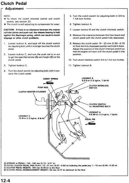

Need some technical advice. Yesterday I adjusted the clutch pedal to stock height (even with the brake pedal). Here's the issue I'm having, stock clutch engagement started pretty close to the firewall (maybe an 1" or so) with a lot of pedal travel prior to that. For the OMNI Power, everything occurs up close to the top of the pedal travel. Good for fast shifts, but a little difficult for everyday driving. The extreme stiffness coupled with a crazy position for my foot and ankle, makes for a whole new driving experience. Is there are an adjustment somewhere else that provides for some "dead space" before clutch engagement? Or do I need to just lower the height of the pedal closer to the firewall (which make it easier to modulate, but makes it goofy looking, being uneven)? I've been driving this Civic forever, so I can't remember where optimal engagement should occur (on other cars). Up top, mid-level or down low. Or is this something along the lines of just re-learnning to drive my car? Thanks!

I think I got it now (after searching around the net and looking at some illustrations). I didn't quite understand how everything worked. From H-T: Basically, you loosen the locknut C. Then turn the rod that it locks. This adds or realeases preload from the master cylinder piston.
Reduce preload (clockwise) = more freeplay
Increase preload (counterclockwise) = less freeplay
There's maybe a 1/2" of freeplay.
More freeplay, and the clutch will engage closer to the floor.
Less freeplay, and the clutch will engage higher up from the floor.
I thought I could only adjust pedal height with the pushrod. Not sure if this is true yet, but I'll give it a shot in the morning.

There's a decent DIY on adjusting freeplay on here, it's not great, but hopefully it'll be some help..
https://www.civicforums.com/forums/1...djustment.html

That helped a bit. I was one of those guys that confused engage and disengage too. Haha.
