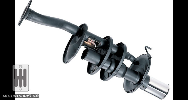

well it helps some performance out without being too loud. if you got an intake, header, and no cat it helps smooth things out. it's kinda the same as asking what's the point of an rs*r, apexi ws, or greddy sp2 exhaust. they're all the same. loud doesn't = more power. that's what the dc5r muffler is all about. here's another pic:

nice. That picture is very impresssive. How hard are they to find? where can i get one online?
