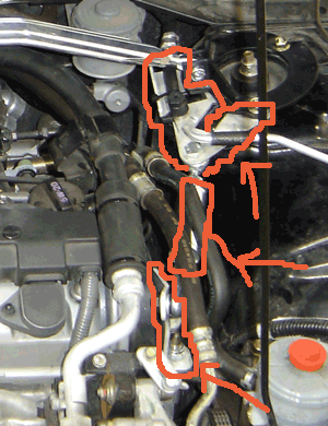

it says "base model" I take this to mean that it wont clear the ex ABS box or lines. too bad its so expensive.

and it doesnt seem like it would interfere with your abs, compare some pics and decide though

here you go.
up top i circled the aluminum bracket that will mount onto your strut tower, from there you see it bolts onto the damper circled in the middle under some hoses. the other end bolts to another bracket which mounted onto the engine.
the fact that the bracket is so high up on the engine is good too, it gives more advantage to the damper through leverage and whatnot. (although on some cars they are mounted higher and may even use 2 dampers this probably wouldnt be nescessary on any d17)
