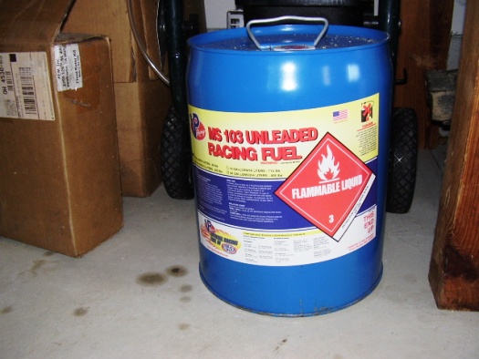

Old Feb 9, 2005
C2i0v0i1C's Avatar
SuperMODrizd
Posts: 26,407
From: Lexington, KY
Rep Power: 585
ur paying to much octane to $
i got 103 for $35

Old Feb 9, 2005
PunkingCivic's Avatar
I need TP for my bunghole
Posts: 7,103
Rep Power: 360
crazy I've never seen a bucket o'gasoline before
Old Feb 9, 2005
4drcivic2k1's Avatar
Turbos, Engines, Chassis and Suspension Tech
Posts: 1,440
4drcivic2k1 is an unknown quantity at this point
You can get those, 30 gallon, and 55 gallon usually.

Originally Posted by Pb4uGo
103 is he highest unleaded offered.
notice I said some
i doubt they are going to ship residentially, we have to have a 200 gallon order for them to even show up. 55 gallon drums damn oil barrels
