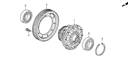

From a 2001:
From a 2000 D16 series:
They use the same bearings (80x40x18), same shim sizes, etc. I'm venturing that they will fit. As I stated earlier, I want to try one of the D16 LSDs in the D17 tranny. Its been proven before that the D17 tranny bolts up to the D16 (I believe Kezay or someone did it).
Give it a try, if it doesn't fit, just resell it on Honda-Tech - the OBX LSDs are hot stuff right now because they are $500 cheaper than a Quaife and do pretty much the same thing.

thanks for the visuals!
it looks like the gear pitch on the d16 diff is coarser than that of the d17...
i really am not interested in being a test subject... but ill see if any more information materializes.
