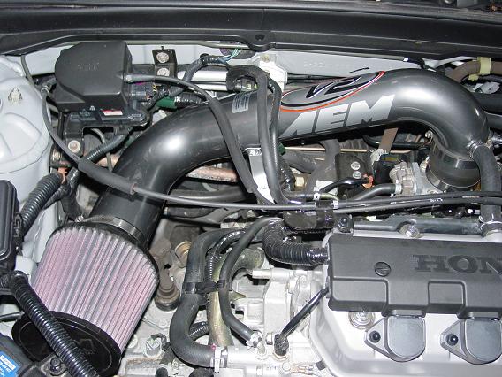

I did a full ground upgrade and installed an AEM V2 intake and damn from 4500 upward the car feels so much more lively... Also the sound is f'n sweet... I HIGHLY recommend the AEM V2 for LX/DX owners... I haven't heard EX owners have as good results... but for my car... I've been extremely happy with it...

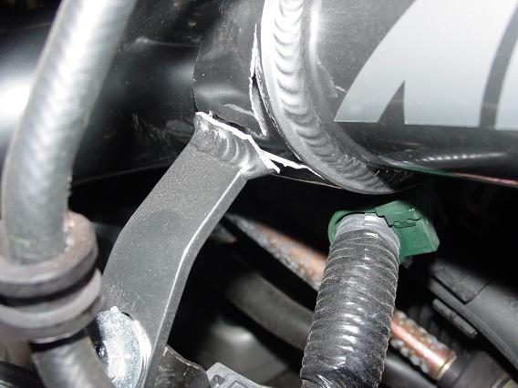

I had the V2 for 4 months, and then it broke... I cant upload the pictures here b/c they are about 1.5 megs each. If you want pics or details, let me know. I think I'm 1 of 3-5 ppl with that problem though..... I still recommend the V2

Here ya go folks.... the pictures with my broken AEM V2
ID:	31284   Click image for larger version

How the ... did that happend?

Looks like someone forgot to turn the gas on while they were welding that back at the factory. Not having argon flowing lets oxygen get into the weld where it oxidizes instantly at welding temperatures and makes the weld brittle.

WEll, I did have it replaced. Josh at AEM... and I was nice... and so was he. I sent him some pics and he replaced it, no charge. Just took em a while to get everything in order... have to be persistent. And I also like my V2.
