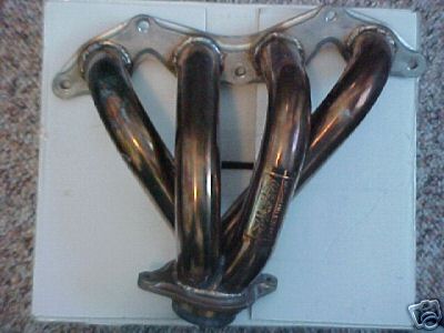

Does this header look right for ex?
Looks like theres 2 holes for the o2 sensor?
I didt take a pic of the downpipe

Lid that is a LX header...I know I have one myself....looks real good once it blues up too. I did not notice any gains and it did give a raspy sound to my exhaust. that is ok though does a great job if you ask me!

and lid that header is for a lx not ex. the o2 bungs are in the wrong place for a ex...

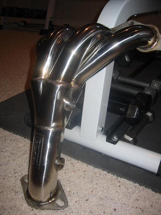

lid your's should look like this

^^u got that photo off eBay lol. im watching out for that one.
anyone know if that'll bolt on directly onto my 03 ex coupe auto?

So can i install that one on my car or should i call the place up and get another one....
I dont really want to wait any longer ....
And yes I am a ex!

yes the shorter one shown bolts right up to ex.
both of your cars.
i have that one. works fine. probably not pure stainless else it wouldn't have rust up that much. its a DC replica.
the DX/LX one is kamikaze replica design.
the DX/LX is a good bang for the buck. as for the EX one, dont expect to feel anything. but it works.

Ok so its got 3 holes total ....
2 on the header and 1 on the downpipe Doesnt the ex only have 2 o2simultors?
Can I just plug up one of the holes on the header?
SO has anyone installed lx header from obx on there ex vic?
Do i still need to use the downpipe. Me and My friend are going to try to install it on sun cause he got hella tools :

you will at least have to cut the downpipe and weld a flange on the part you cut below the headers for it to bolt up. and the OBX downpipe won't work on your car...it is too short. You would have to buy one off ebay or something if you gotta have a new downpipe. Even still with the LX headers you will have to cut and weld on that one too plus you lose your cat and your check engine light will come on till you get an o2 sim. if you use this header and cut the stock downpipe leave the after cat o2 sensor where it is and you can put the before cat 02 in either hole....then just get a bolt and plug the 3rd hole....that is what I did...works fine. L8ta

Yes We tried to install It but the downpipe it came with was not long enough!
Also I could not install the header on my car cause the stock downpipe was to long
So I have to return
If they dont let me return It I will let it go for 100 + shipping Brand new Obx stainless steel header for the hx lx 01+

errr u're looking at the wrong one. the LX one wont bolt on to EX civics. the one with 2 holes on it wont fit on the EX.. u'll need new downpipe welded on.
ex has only 2 holes. and they're both on the downpipe/cat convertor.
the much shorter one is the one for EX. which as u can see.. has no o2 sensor holes on it.
