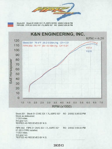

K&N FIPK II is the best intake. It's a short ram intake but it has a heatshield to keep out warm air. It's also made of plastic so it doesn't get hot like all the metal ones (AEM, Injen, etc.). It also has no low end loss of torque, unlike just about everything else out there. As far as sound, it sounds the same as stock up through about 4k rpm and then gets a bit louder from 4k to redline. But it's not annoyingly loud at all, it sounds nice. And besides, you're only above 4k rpm for a little bit when accelerating hard anyway so it's not going to be loud all the time like some exhausts.
