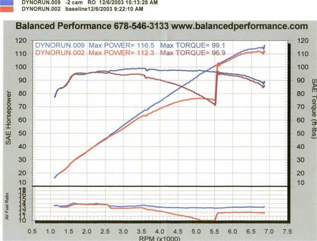

ALright.......lets see if this works...........

Thanks for posting Fly....As you can see, the first run before tuning shows a decline at around 75 and then jumps up 25Hp when the VAFC vtec output kicks in...That alone shows you that there is something that is not right...The blue lines represent the final tuning which took that dip and spike out and made a smooth/significant gain...My car feels alot better in mid range where I noticed the decrease in power after the KMS IM install...I'm pretty positive that the stock manifold will yield alot better gains...Any questions?

Also, look at the bottom graph(air/fuel ratio) My car was running really rich before the tune...The tuning took car of that though

Damn! I like what tuning did to your powerband. It made that dramatic drop turn into a smooth upward incline. I really would not mind getting a tune done after I get some of my more costly mods done.

holy crap. you had no power before... i mean the afc ii bumped it up... the tunning helped the most.
still. tune to get a few hp? thats gay. grr.

why does it say mustang at the top of the dyno sheet

that's the company/software of the dyno itself
