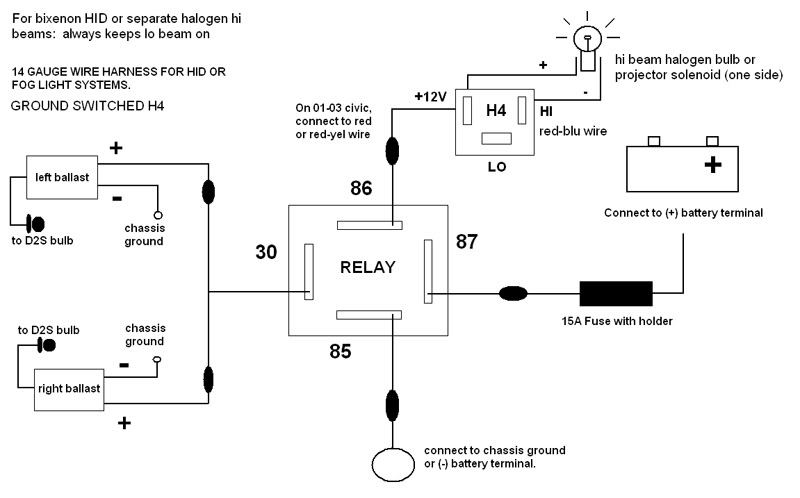

Just make sure you have a good wiring harness. Before you do this you're going to need to understand how the H4 works.
If you dont already heres a brief explanation:
Here is your H4 plug
Highbeam Ground (Blue/red wire) |___| 12V Power
Low Beam Ground
Both grounds get power from the 12 volt but when you switch the highbeam on and off switches grounds respectively.
Since the H1 isn't the same shape as the H4 you're going to need to make sure it's grounded to both low and high so the bulb doesnt switch off when you go to high. You'll also need to make sure the MM highbeam solenoid is grounded to highbeam and plugged into the 12v to get power.
Here's the wiring harness model I used, made by gearbox:
Old Jul 15, 2011

Alright, new question. I tried wiring everthing up, and when I wire the low beams to the bulb and the high beams to the Morimoto solenoid everything works like it should..... except that the bulbs go off when you turn on the high beams (makes sense).
What I tried to do was wire BOTH high and low into the HID harness and left the solenoid wired to just the highs with the idea that the bulbs would stay on whether I had highs or lows on, but the solenoid would switch on for high beams.
Unfortunately when I wire it like this, when I turn the low beams on, the highs automatically come on (they cant actually be turned off). What's up with this? Anyone have any ideas? Thanks in advance

Did you use gear box's diagram? You shouldn't have anything plugged into the low beam because your wiring harness will take care of that.

Ah, alright, I'll try just connecting to the low beams. I didn't make my own harness, I'm using the DDM one, but I'll give it a shot. So even if nothing is connected to the low beams the HIDs will come on when I turn the low light switch on and the solenoid will activate when I use the high beams?

Did you get the H1 Harness from DDM? Because if you did then it won't be of any use to you. DDM is thinking you're installing the HID into a car that was made with factory H1 bulbs, not accounting for retrofits like ours. I ordered from DDM too and had to make my own harness in the end because it didn't work. You could probably alter it in a way that works, but you'll have to change a lot.

hmmmm crap. I can get the H1 harness to work for low beams, but not high beams. I think I'll use their harness for the time being and make my own harness in the mean time.
