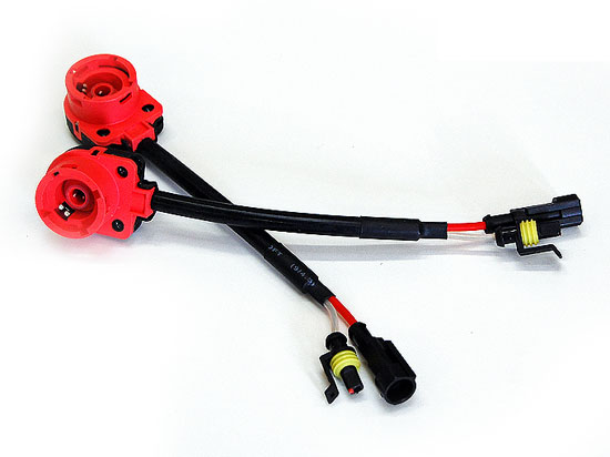

the bulbs you're currently running have this type of connection between the bulb and ballast, right?

yeah your old ballasts should work with new h1 bulbs (but not d2s).
Old Dec 9, 2010
Rep Power: 512
Re: Morimoto Mini help
That pic was taken from an H1 HID bulb. If you get the morimoto minis, all you'd have to get would be the H1 HID bulb. A D2S bulb has a different connector, but you can always buy an amphenol to D2S connector. That's what I'm running on my TSX retro.
