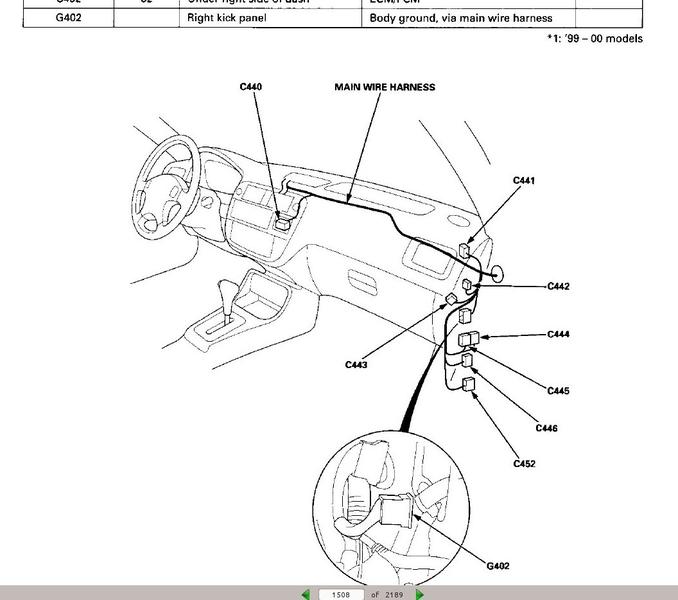

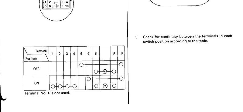

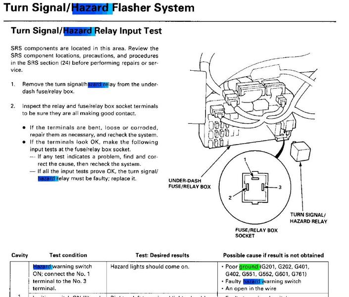

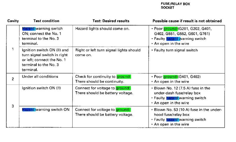

With a multimeter would be your best bet. Personally I'd check the bulbs an inspect the wiring to them first. Then start troubleshooting grounds. I took some screen shots from my FSM for my '99 EJ6 for some info on the ground and troubleshooting.
Hope it can help.
