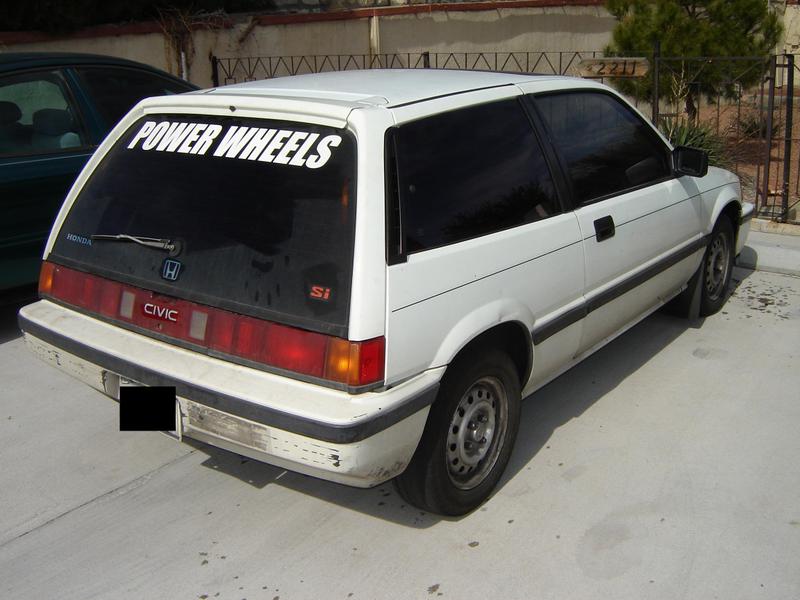

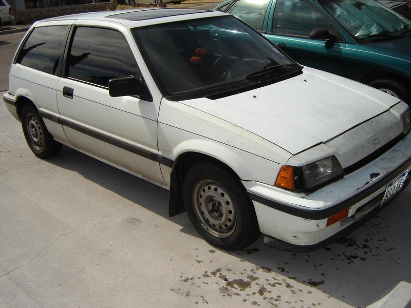

Okay i want to lower the rear a bit more... it's a spring and shock absorber... as for the front it's a couple of struts... but they aren't the regular struts with the spring near the top... and i apparently don't have springs in the front... is that strange? i want to lower the car just a bit i've already looked into Tokico and they've got some struts for my car... as for the rear springs i'm having trouble... that and if i'm lowering my car a bit how would i go about doing it without springs in the front? if i'm not making any sense please ask to clarify i'll do my best... Thanks

That car has Torsion bars for the front "Spring"... you may want to read this thread for a better idea for your car
