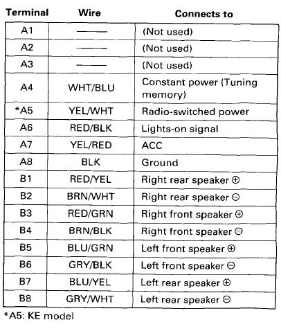

Here are the wiring colors for a 94.

thanks guys..it was a fuse problem..i took every single fuse out and checked them..thanks for the tips everyone. appreciate all the feedback.
